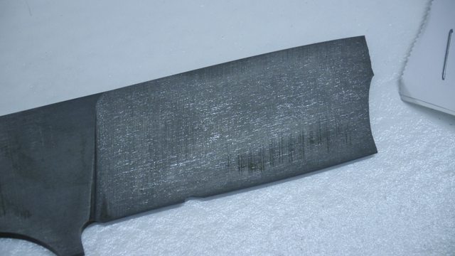

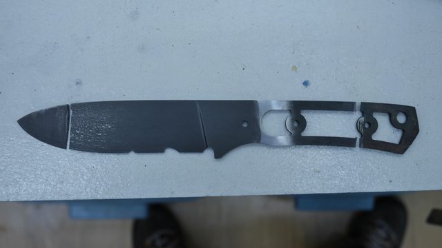

Ok guys, I'm going to say that I think I've accidentally called wolf on this. Today when I was polishing up the blades in this batch to see if they were salvageable I realized that I've seen this carbide segregation (or whatever it is) in A2 before, in probably all the knives I've made from it in fact. In the past I would see little ghosts of it during finishing and inspection, but I never thought much of it as I've seen much worse orange peel in other steels.
Thinking back though I've never acid-etched an A2 blade before, and the results of that were what startled me so much...

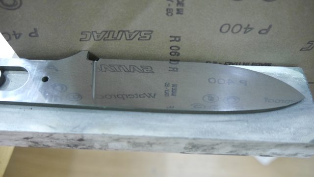

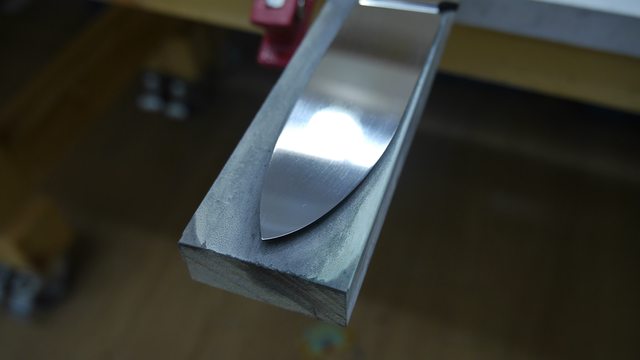

I took one of the knives from the batch all the way up to a mirror finish on one side to see if I could highlight the carbide segregation:

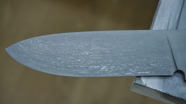

You can see it as streaks of 'orange peel' in the finish in the next 2 photos:
Full size: http://i.imgur.com/DGSNnPT.jpg
Full size: http://i.imgur.com/FobaeK4.jpg
Everything is much easier to see after just a few seconds in Ferric Chloride:
This carbide segregation stands out pretty clearly in a mirror finish, and would definitely not be suitable for a knife intended to be finished that way. But I only ever take my knives to a ~600 grit satin finish in which case the issue pretty much disappears.
