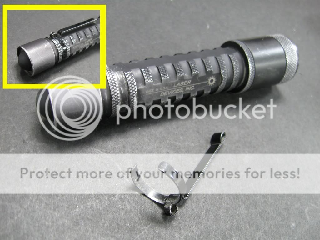

Alternatives to JB Weld?

Considering that both the clip and flashlight barrel are extremely thin, we're talking about very narrow margins of error in terms of not ruining the flashlight.
Here's the promised picture:
If you could find a spring clamp the right size, you could fix that in less than a second with no modification other than cutting off the clamps protrusions. You might even be able to use a keyring if it would fit.
..i don't see why drilling/tapping will destroy the integrity of the tube..

A couple of twists of aircraft stainless safety wire would do it. A local machine shop might have a spool, if there's no small airports around.
if you try to JB weld the clip to the body, the tension of using and releasing the clip will eventually break the bond, especially since they are two different metals. BUT if you are willing (and this is a slight variation on the wire-tie idea) to wrap a piece of steel shim AROUND the round part of the clip -- so you have a sandwich of flashlight-clip-shim -- you could either JB Weld or solder the shim to the clip. Same metals, & no real tension between them to break the bond. If you use a hi-carbon shim it would be easy to blue or patina it dark, and it doesn't need to be thick at all. Hope that explanation makes sense?
for what it's worth, I find that the quickset JB Weld is not quite as good as the regular. get the original that cures slowly.
I second roughing the surface where the clip will mount. if you think you could drill a small hole without screwing up the internals, that would be better as long as you use a very small dab of JB Weld so as not to have enough ooze in to create a conflict with the battery fit.
some of the other suggestions here seem unwieldy to me. if done correctly JB Weld would not even be noticeable
