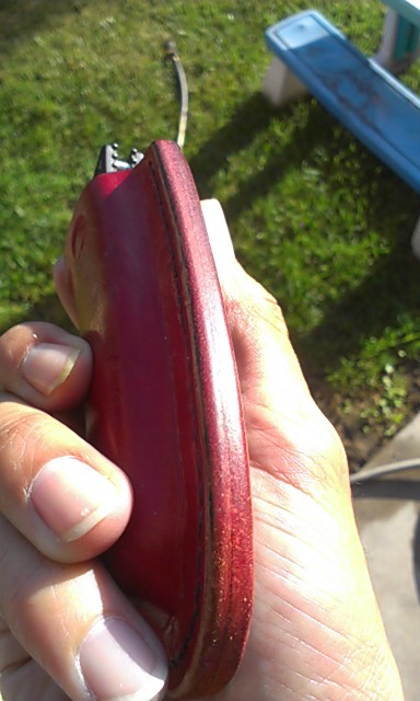

A lot of the time it really comes down to the leather being used, as to how well it will burnish. I know you use the Wickett & Craig stuff so that should be good, but some parts of the hide can be a bit spongier than other sections.
Otherwise I concur with the rest of the good folk here, and Paul, nice sir
and Eldergeek, that is sleek....(hey I'm a poet )
and Ken, you certainly do an excellent job of burnishing!
Myself I do use the Gum Trag, my rote of work goes something like this
Glue down the pieces, let set, trim close with a knife
Sand down to needed width, sand down a radius along the edge
Dye to match the rest of the sheath, while the dye is drying I'll rub/burnish with the bone folder (be sure it is a smooth portion of the bone folder, I've sanded off the mfg name and # on mine)
Once the dye has had time to dry and after burnishing, I'll had sand paper with 1000 grit, possibly dye a second time (see we don't just dye once all the time lol )
Burnish again and apply some Gum Trag, while that is still damp I'll burnish and when dry I'll lightly sand paper and apply a little more Gum Trag and burnish a last time.
Once the sheath is done, I apply a coat of Atom balm wax and brush it to a final finish.
G2
