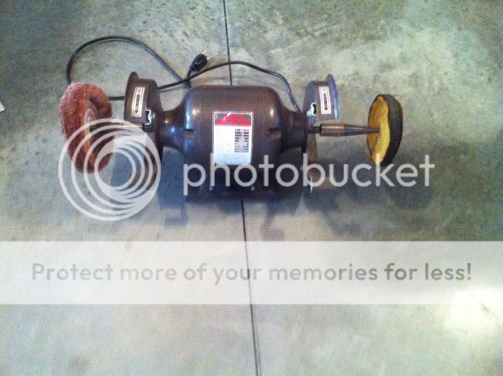

The HF buffers run at 3650 RPM. You really need something slower. Fast polishers can burn soft handle materials.

If you are bogging down a 1 HP, 3600 RPM machine- you use a completely different method of buffing than I do!
I have the Grizzly, and use it quite a bit but I prefer a slower machine for most work.
I agree completely with Mr. DeShivs. I am on my third buffer and it is a 2 speed 1725rpm/3450 rpm and I will probably never use the faster speed unless I want to use much smaller buffing wheels. 1 HP is plenty for a buffer. Most of the finish work should be done by sanding before a buffer is used. I buff for about 30 seconds at the most for my finishes. I use green Chrome on the sewn buff and a white compound that is about 1300 to 1400 grit with a loose buffing wheel. Larry

I was kind of nervous buffing for the first time and I had a death grip on the knives.
I think I'll be OK though, the wheels are small. I took the guards off. I will probably buy new wheels and keep these in ziplock.
One is loose? and the other is sewn.

Josh- go ahead and remove the rest of the guards. You don't need those guard halves sticking out like that.
I did Bill, they seemed pointless as I don't plan on putting the grinder wheels back on for any reason. I saved them just in case though.
This thing is only 1/2 HP and I actually did bog it down at first, but I am just learning how to use it and it seems I don't need to push that hard.

The fast buffers can be effectively "slowed down" by using smaller buffs. A 4" buff will run at half the surface speed of an 8" one.
Which buffs do you guys usually prefer, 1 sewn and one loose or do you have several different ones?
