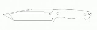

This new design I'm working on is meant to be an outdoorsman's fighting knife.
I designed it from the beginning to fit in the larger 8" Spec-Ops Combat Master sheath:
http://www.specopsbrand.com/combat-master-knife-sheath-long.html
Here's what I've got so far:
7.9" blade, 13.75" overall
Scandi grind at the tip, 45 deg swedge on top, flat grind everywhere else. Pommel strike. Integral guard. Finger cut-out for detail work.
Made from the same 3V as the MUCK.
Let me know your thoughts - and I'll try and post anything I've forgotten to add.
