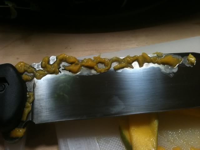

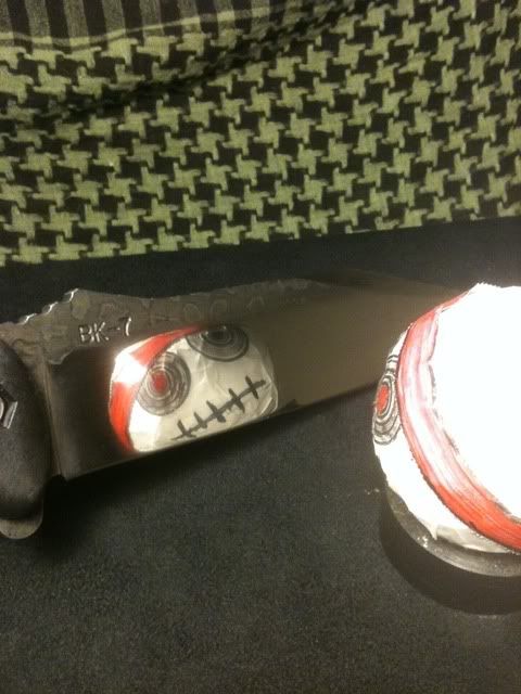

BK7 hand polished to mirror finish, starting with 120 grit, ending in 2000 grit, with about 12 grits in between. And 3-stage Patina using Lemon juice, then Mango chunks, then Vinegar/Whole grain mustard mix.

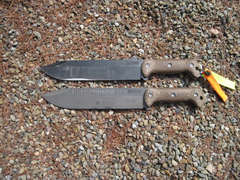

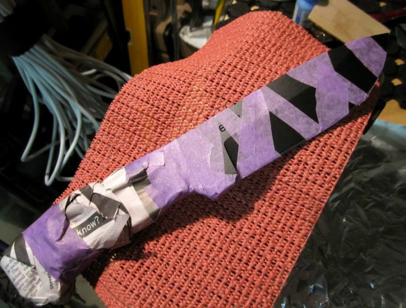

My Bro owns a window tint shop and hooked me up with the BECKERHEAD 111 decal. I stripped the paint off the blade and laid down the decal then applied 5-6 coats of paint to the entire knife. Once the paint had dried I peeled the decal off one letter at a time exposing the bare metal. I let it soak in the echant for roughly 12 hours. Pulled it out, cleaned it up and stripped the rest of the paint off. Then she went into the vineager for an hour or so.
I will add this note of caution. If folks decide to try this, make sure your paint is good and dry before etching as the echant will attack any bare surface. I did end up with a couple of little bubbles on the cutting edge and the solution did take some material away from those places. If I were to do it again I would try and keep the cutting edge out of the solution all together.

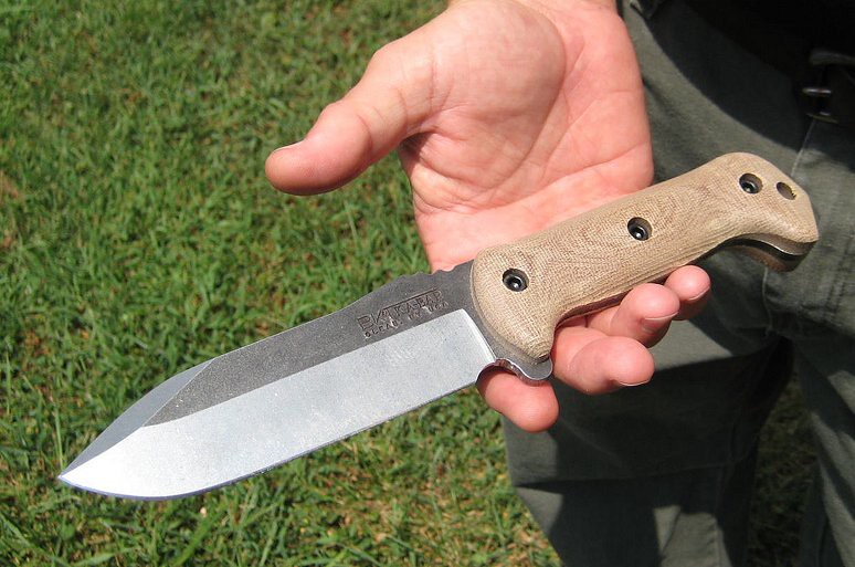

Just a couple of pics, still in the works. Got her stripped, convexed, micarta scales with stainless hardware. Thinking about retrying a vinegar patina and dying the scales an OD green.
