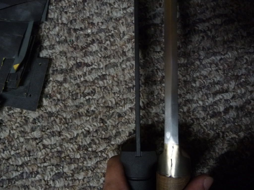

My first "kukri" was a Kabar kukri-machete so I guess I can give my opinions on the matter. Right off the bat, the hollow grind on it proved to be quite annoying (terrible idea for choppers) - it got stuck in practically everything. I eventually convexed it, and it admittedly worked better afterward. However, I picked it up with the intention of replacing both my machete and hatchet for camping (which a proper kukri would allow for). Simply put, it just doesn't have the mass or thickness to take care of the chores a hatchet is needed for and hence isn't worthy of the "kurki" title - it's really just more of a forward bent machete. Seeing as though the Cold Steel version is even thinner than the kabar, I really don't see it being fairing any better.
Here's a picture to illustrate - the Kabar kukri machete's spine vs an HI 18" Vojpure's:
