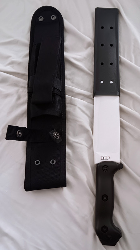

I just received mine. The internal plastic insert came out almost immediately when I tried to put the knife and the cardboard protector, that the knife came with, inside the insert. (shown in photo). The cardboard protector didn't fit, and when I pulled it out, the insert came with it. Which is what I wanted in the end, but the fact that it came out so easy was a bit alarming.
So just to be clear, the insert on mine was not sown in to the sheath or mechanically attached in any way except some cheap glue.
I wish someone just sold a fitted insert for the OEM sheath so that the sheaths don't get wasted.

why'd you try to put it in with the cardboard on? Seems obvious that won't fit? The Becker knives itself have decent fits in my factory sheaths. Not much room to wiggle them around,
No its all good. The insert is useless either way. I actually wanted it to come out so I could examine it.
