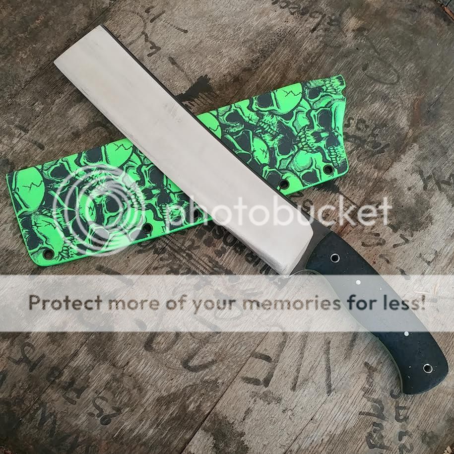

I have accumulated a few comp knives to this point, and I have another in the works.
I was curious if there would be any interest in my first one.
The design has changed quite a bit since then and I truly have no need for it.
It has been used and certified in competition and could be again if someone so wished.
It is Full Zero Convex Ground 4V at 62 Rc.
Even if you don't want to get into Bladesports I am confident this would be the best cutting Camp Knife you could get. Made to be tough, used hard, and hold a great edge.
Price is $SOLD
Includes US Shipping
Comment, message, or email if you have any questions.

I found some time to get out with your BSI competition knife and try it out against some other choppers.
Your knife has the best design I've seen on several counts. Obviously, choppers are always a compromise between putting maximum weight/momentum at point of impact on one hand, and on the other hand allowing enough dexterity to control that momentum, so managing the swing doesn't fatigue the user or make use unsafe.
After using yours on seasoned deadfall from 1” dia. up to 4” dia., that compromise felt very close to ideal--wonderfully controllable because of the compact blade length, but with enough mass to deliver devastating impact.
Second, bite depth is obviously maximized by blade/edge geometry, and your knife has a thinner edge than most of the blades in my lineup--a significant advantage. Even with the thickest blade spine overall, yours bit deeper than several longer, thinner blades of similar weight.
Third, ergonomics are a key factor to me for accuracy, control, and reducing fatigue. In hand, yours feels the best to me ergonomically of anything I have.
In short, I was very impressed. The only thing that bit deeper than yours was a heavy cane machete with a broad nose for putting more steel/weight behind the edge without increasing thickness, and it has significantly greater blade length. But the ergonomics on the machete couldn’t begin to compete with your knife.
This is the first time I’ve used a BSI competition knife, and I’m really impressed with the evolution of the design under your craftsmanship. Fine, fine blade.
Thanks again for allowing me the opportunity to own it!
Will
