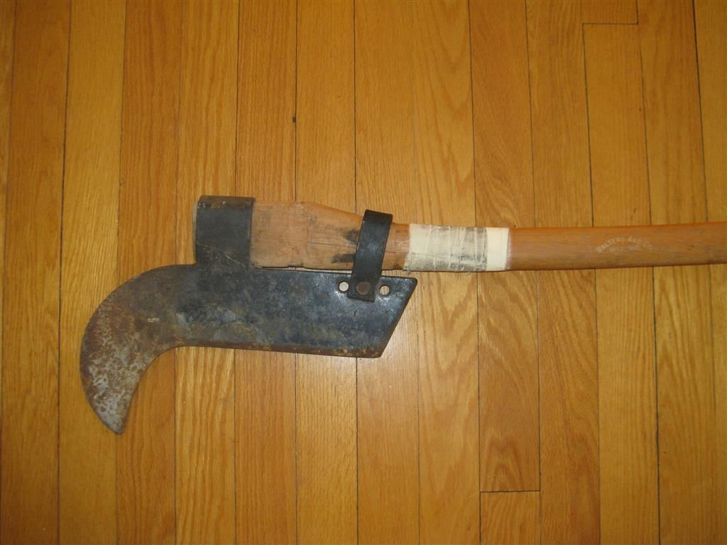

Regarding those relatively heavy USA-made brush hooks, here's a description of how to use them, from a USDA booklet titled "Equipment for Clearing Brush from Land" published in 1961:
books
Brush hooks.-- Brush hooks are useful in cutting the stems of growth. The brush hook is swung like a scythe. It is sharpened by grinding with an abrasive wheel.
Machetes are mentioned for cutting "stems or branches", but the brush hooks are said to be for stems (not branches). This is written in the section on "Small Brush", defined as woody growth having stems no larger than 2" diameter.
Farmer's Bulletin No. 2180, Equipment for Clearing Brush from Land, USDA, 1961

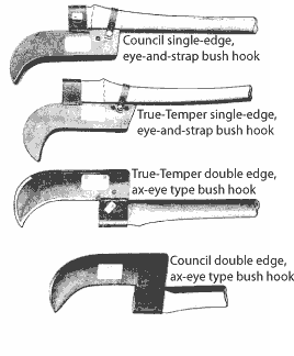

From a USFS publication:
Bush hooks are used for clearing work that is too heavy for a
scythe and not suited for an ax. They are available with single-edged,
eye-and-strap blade, or double-edged, ax-eye blade type.
They have hickory handles 12 to 36 inches long and weigh 2 to 4½ pounds.
from Hand Tools for Trail Work, USFS
