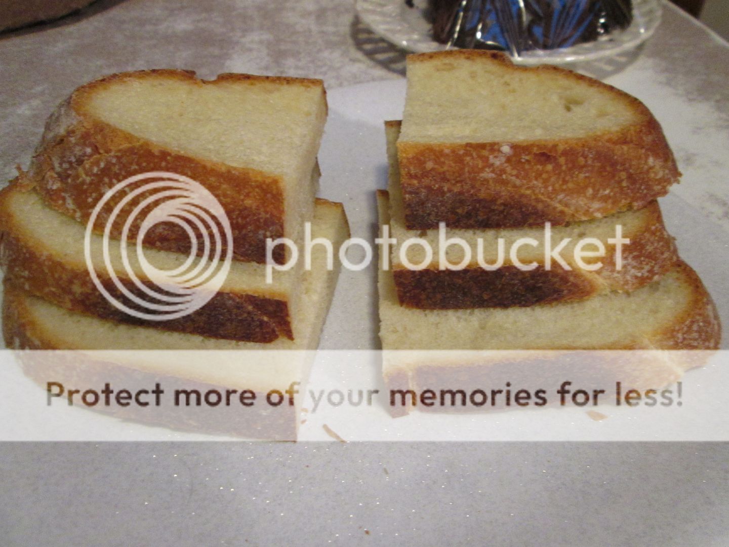

It was somewhere around this stage that I decided to do a review on this thing. I found a format in the past that I very much so enjoy for testing. Kitchen duty, outdoor work, kitchen duty. No sharpening in between. So, I brought this thing to its usual edge, and on I started reviewing.
For the first stage, I went for a nice salad. I know how annoyingly finicky tomatoes are, so it was a great test subject.
[URL=http://s103.photobucket.com/user/senor_blanco/media/IMG_0011_zps53pnlrid.jpg.html]
All I can say, is it is actually an excellent kitchen tool. I cut through everything as good or better then my current kitchen knives. It cut super finely, with no crushing at any point. It even cut through a light bread without crushing it even remotely. Kitchen work is not its intended purpose, but it did the job very well.
Kitchen Performance 1 rating ---- 9/10

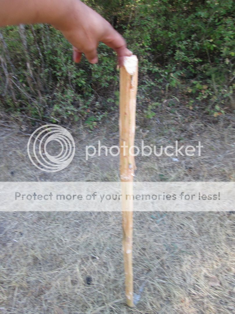

The lucky tree chosen for a few different tests
Limbed it quite quickly and easily
It made short work for bark stripping part two.
It also made it a decent little walking stick, about three feet long.
However, it was better spent making a pair of batons for tomorrows testings.
