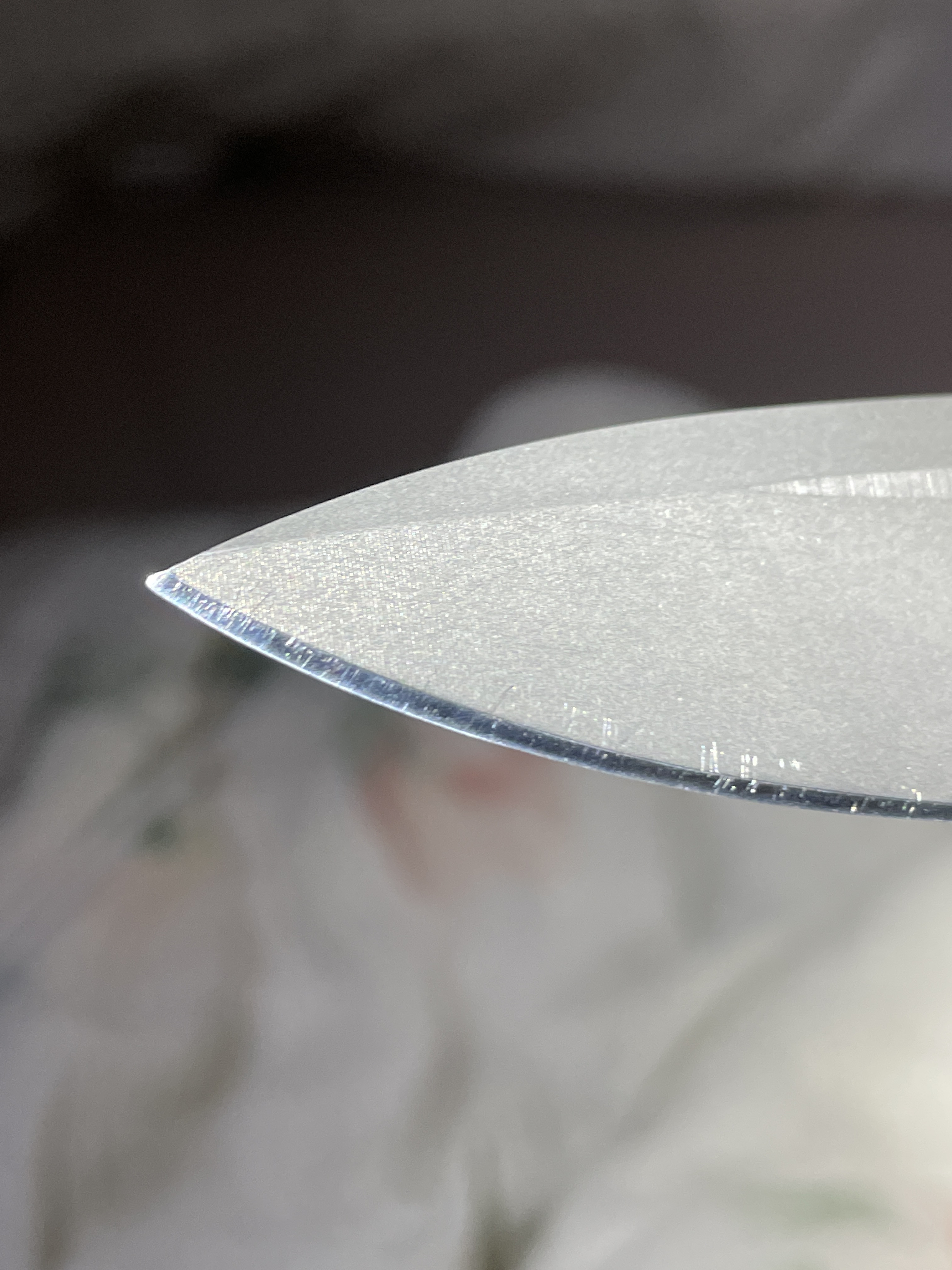

CAN’T GET A DANG MIRROR EDGE!
Do you wipe the stone down consistently, this may help. I always like to see other peoples sharpening results.
Ugh darn it I need to go back and re try this method lol

@Jordan1010 If your blade is sharp, just use it until it's dull. Then, for your next touch-up (with burr creation), use only fine abrasives like 204M or 204F. The 204M will get down to your scratches fast, erasing them.

While i cannot prove it, i dare to claim that the erratic deeper scratches stem from the early stages (320 diamond stone), yet not from the stone itself but from the steel shavings off of that stone. The steel shavings have no place to go, or some of them get stuck in the stone.
To get the deeper scratches out, one would need to go back a couple of steps and grind with a permaclean stone until you've reached the depth of the deeper scratches, hoping that you didn't create new deep scratches in the process. Very challenging.
In your place i'd just use the knife and from now on sharpen the edge with higher grit stones only (i like ceramics). They produce micro shavings only, and over time your original deeper scratches will be gone. It'll take some time until you get there. Basically i am saying, do NOT go back to the diamond stones.

This "permaclean stone" that you mentioned, what is that. According to google that is not an actual term for anything to do with sharpening. Please enlighten
@Kcsstrat i've cleaned the post. permaclean = never gets dirty. an imaginary stone which ive been dreaming about. never mind.
RE: "CAN’T GET A DANG MIRROR EDGE! "
I find a reflective "edge" is the result of blunting, and too much focus on a mirror bevel during sharpening many times results the same. Focus on sharp results greater satisfaction in my opinion. YMMV
