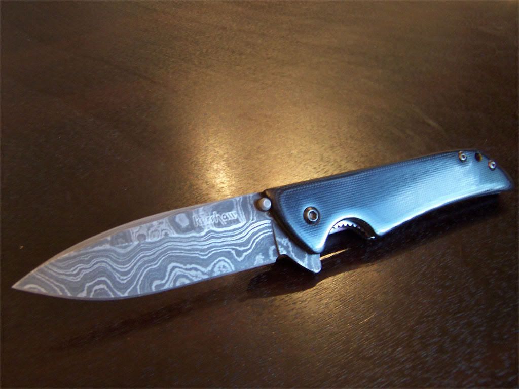

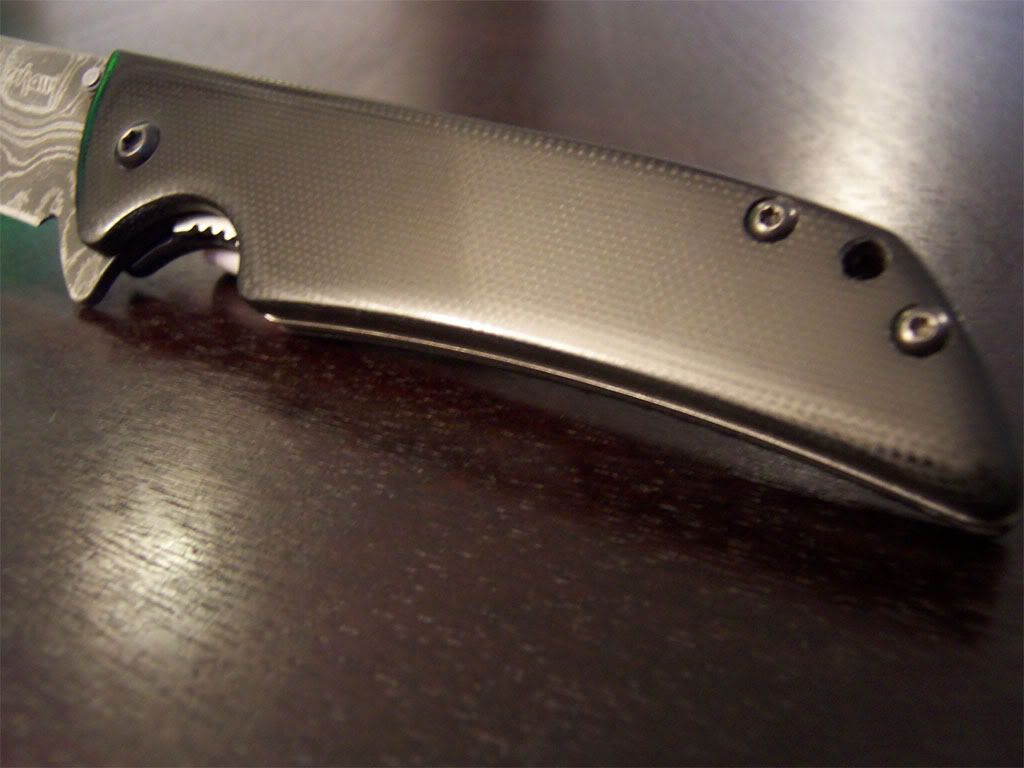

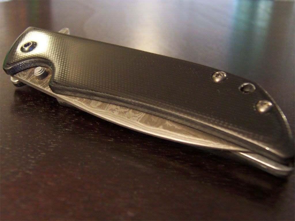

Yup you sure can. I polished these myself:
Polished Spyderco Persistence:
Polished Kershaw Skyline:
The two original Kershaw assisted opening knives, the Random Task knife and the Ricochet both had polished G-10 handles.
