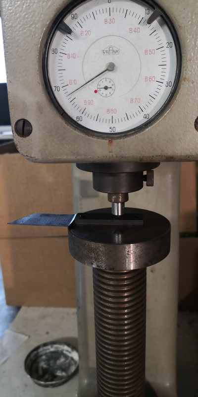

heat treat done! After quench hardness was 64/65 Hrc but after cryo, incrise to 67/68! really impressive
By the Way, after 2 temper at 1000F 540°c now it is 61/62.... I can Keep this hardness or better do a third temper at a bit higher temperature to reduce to 60?

I would be a little worried with the accuracy of you hardness tester. Those numbers are a bit high for just about any alloy. If I had to guess I would say your sitting around 5hrc lower then what your tester is showing. Even in the best situations with testers and standard test blocks your going to be sitting around +-1rc. We use tighter tolerance calibration blocks that are +-.5rc but thy are quite pricy. We just had to buy another one as we had completely used up the last one. We surface ground it down to a fresh surface but in all honesty it’s now at best a ballpark test block. It seams to measure the same as it did but nothing we would calibrate with.
You can get higher accuracy in hardness testing but generally requires a different tester and a much more strict surface condition. I think the industry’s standard is a tukon microhardness tester. It uses a 4 sided pointed diamond. You then use a microscope and measure the dimensions of the impression. This is way overkill for knives and would take way to long. Plus in all honesty you will not notice much if any difference between say a 60 and 61rc blade. But you sure as hell will if a blade is 55rc and your thinking it’s 60rc. So I circle back around to saying you should take a look at your tester and calibrate it have it calibrated.

61-62 Rc is a good target for 10V.
67-68 Rc as-quenched after cryo is not crazy for 10V. I've seen 69 Rc.
