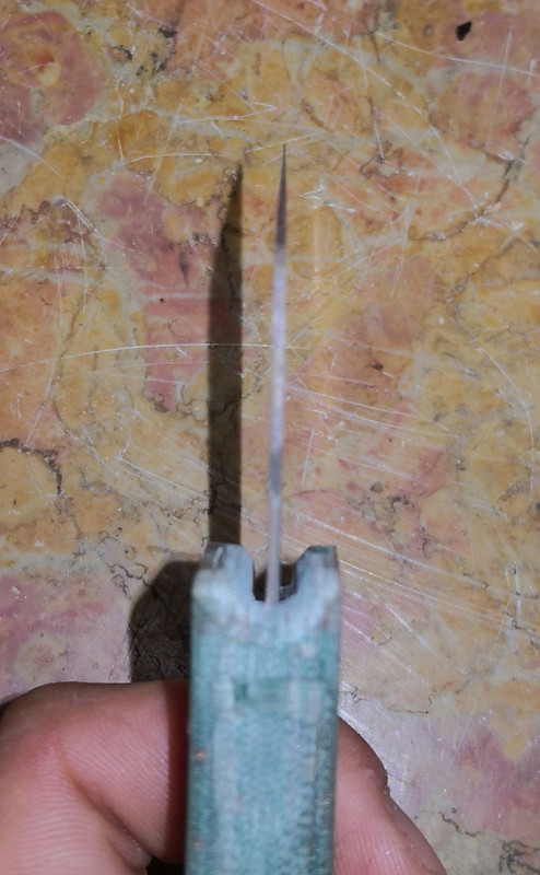

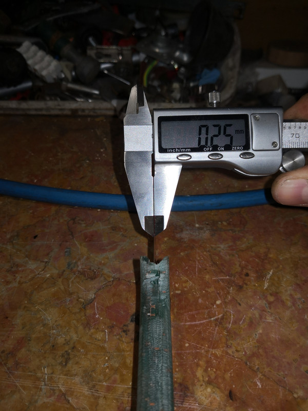

I'm sorry but there's nothing cool about it! It's just a tool with a very ugly design and a very rough finish! Only can cut the cardboard with an ease that a knife will never be able to! I found some problems in the realization of bevels, low angles and low thickness at same time are difficult to manager (for me)!
thickness at the edge
Spine and tip
Ugly but ergonomic motherboard backelite handle
Now let's work!

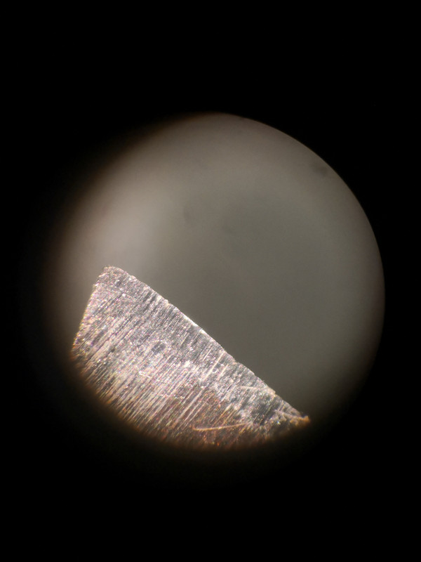

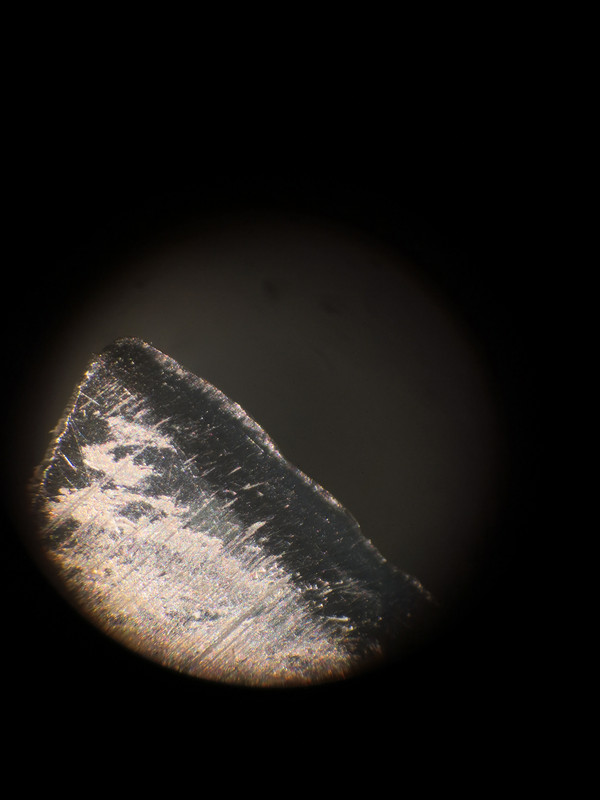

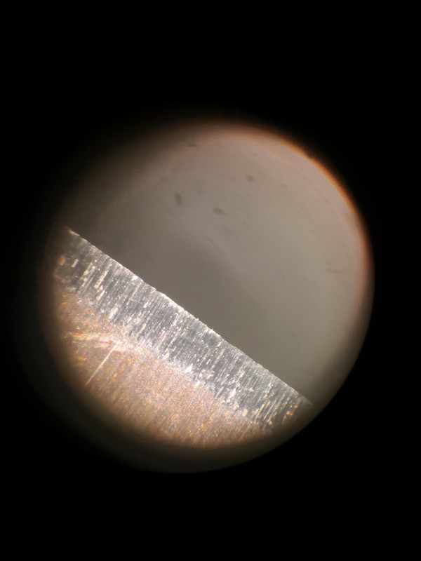

I feel compelled to share the results with you after a week of work with the 2 box cutters. I remember that both were sharpened at 15 ° dps 600 grit. The 10v (~ 61hrc) has a thickness behind edge of 0.25 mm against ~0.4 mm of the D
2 (~ 63hrc). Although they still both continue to cut well, these are the differences under the microscope.
D2 tip
10v tip
D2 edge
10v edge
