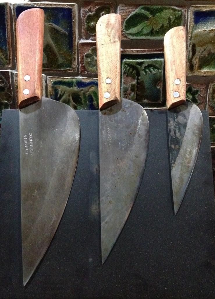

A couple of years ago I traveled through Vietnam keeping alert to what knives were used in the markets for processing cattle and pigs. The most commonly used that I noticed are shown below.
They have thin blades that quickly take a good edge then quickly loose it when worked. I've tried them on skinning and boning cattle. They do the job but need regular steeling before swapping to the next. They are a soft carbon steel.
I purchased these in a Hanoi market for 100 000 dong. About $5 for the three.

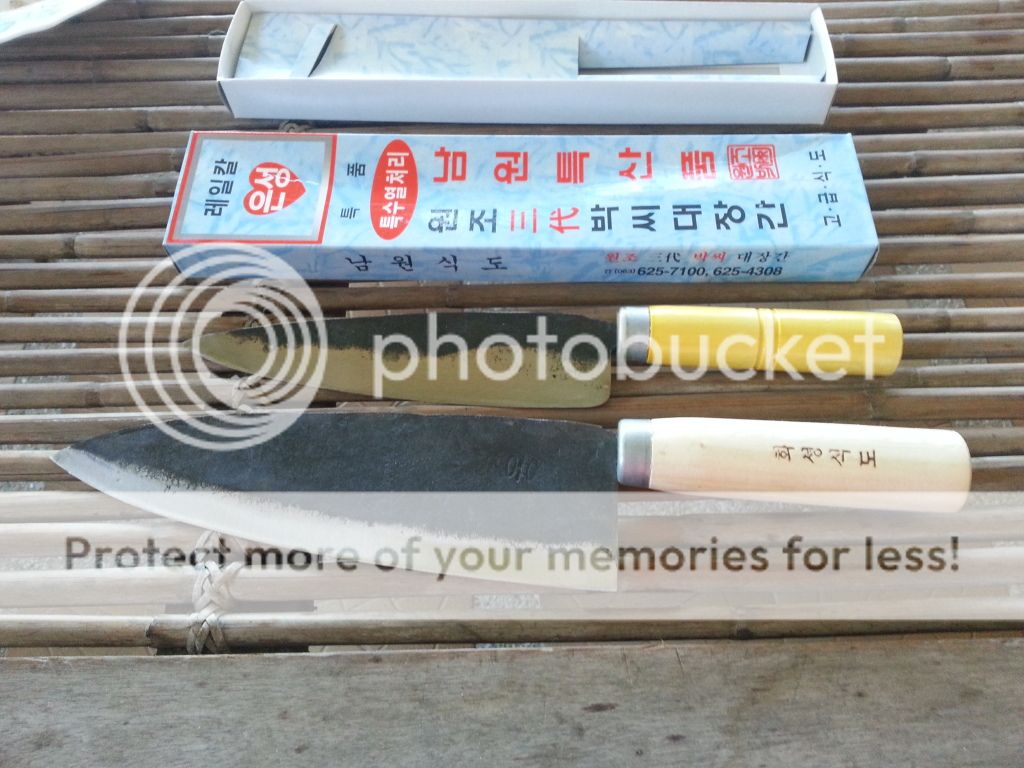

they are similarly shaped to these knives that i got from ebay:
korean kitchen knives. just got these today. $7-8 per knife.
they're alright. haven't tried cutting with these yet. just sharpened them tho.
