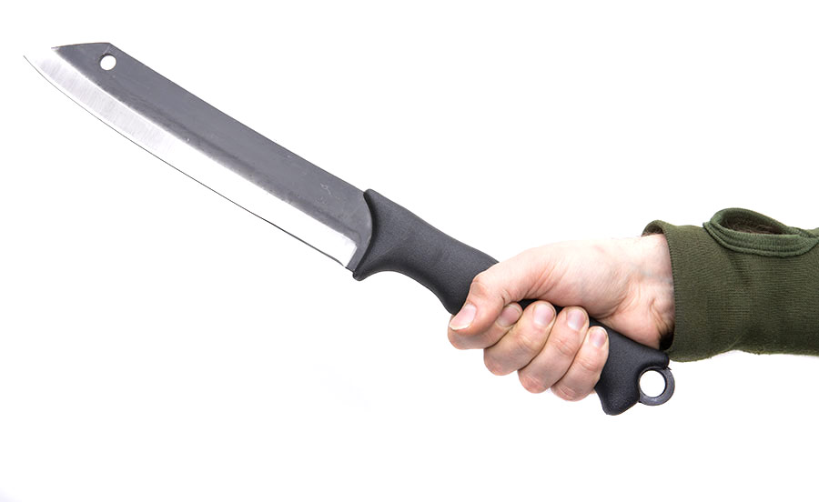

if you have a choice 80crv2 is excellent - check out the skrama made in it - excellent hybrid machete / camp knife
for overall all purpose use it seems ideal, just a bit under 17" total length around 9.5" blade but extremely useful

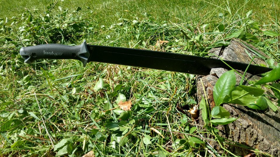

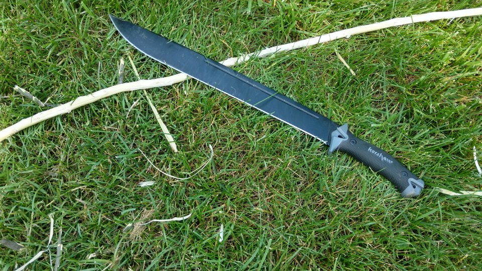

If you just want something fun to swing and easy to put an edge on, with a great handle and a blade that will hold up to most machete-use tasks, it's hard to beat the Kershaw camp 18.
It's one of the most fun knives to swing and chop with in my experience - and a big part of that is the excellent handle ergonomics.
It does not hurt that it is very inexpensive either.
