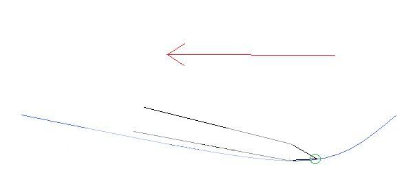

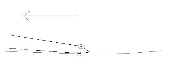

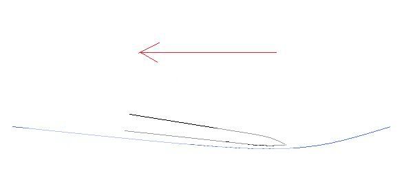

I agree. Here are some really rough paint drawings that explain how I see the convex taking shape.
Here is where I see the 220 doing the most work. Basically, we are trying to knock the shoulder off of the v-grind. At this point we are not trying to sharpen the edge as much as we are trying to establish a smooth curve.
If that was done correctly, then all we have to do is run up through the grits using the right amount of pressure and it should sharpen it up real nice. In the drawing, I have left space between the blade and the paper in order to show what shapes they have formed. In reality they are touching obviously and the paper should be just barely touching the edge while we draw backward.
This is what I think happens when you apply too much downward force on the blade as you pull back. It is rounding the edge, but too much. It is making the final edge angle so steep that it isn't an efficient cutter anymore.
I am by no means an expert at any of this but this is kind of what I think is happening. Sometimes it helps in explaining to draw it out. :)
