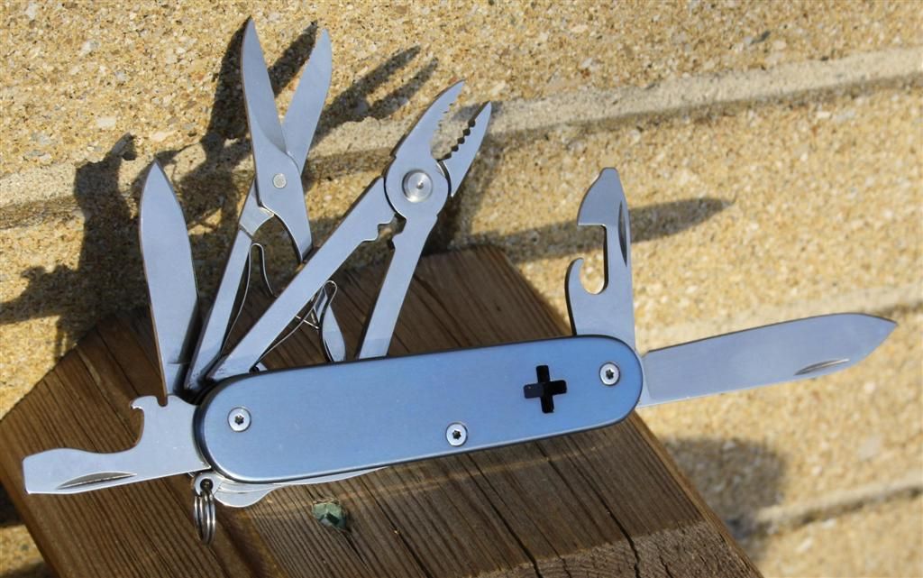

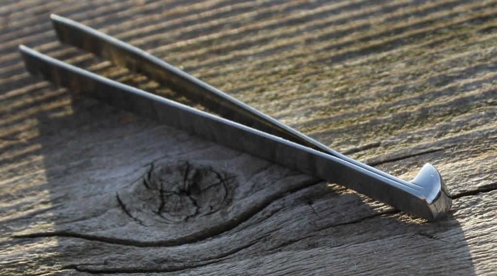

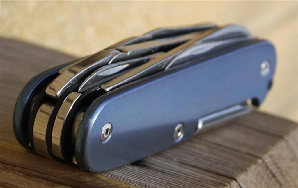

The newest offering I have is Ti scales for the standard 91mm SAKs. To convert a SAK with Ti scales and alox liners as pictured below is $200 USD + cost of donor SAK if not provided. To mill a tweezer slot and fit a stainless tipped or brass tipped tweezer is an extra $25 for labor.

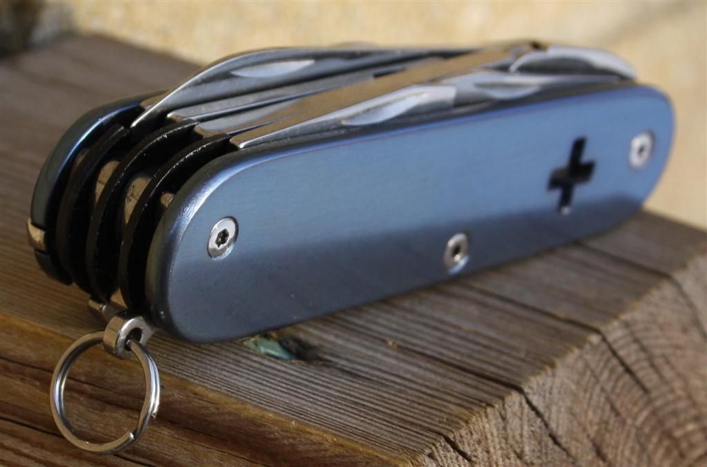

Here is an example I finished yesterday. This is a standard deluxe tinker with blue anodized Ti-6-4 scales, black alox liners and stainless steel tipped tweezer.
That is a Great looking piece!

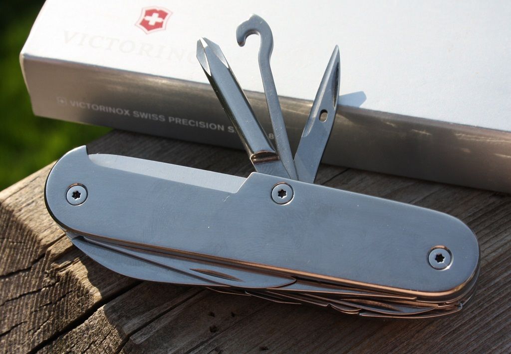

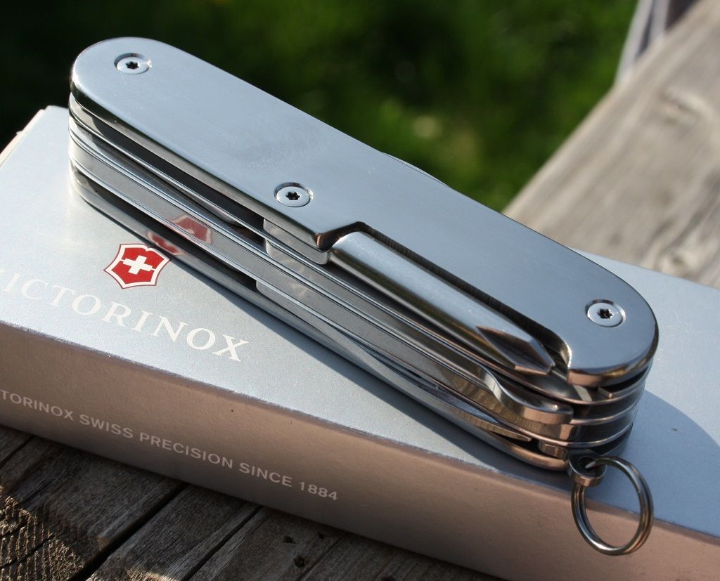

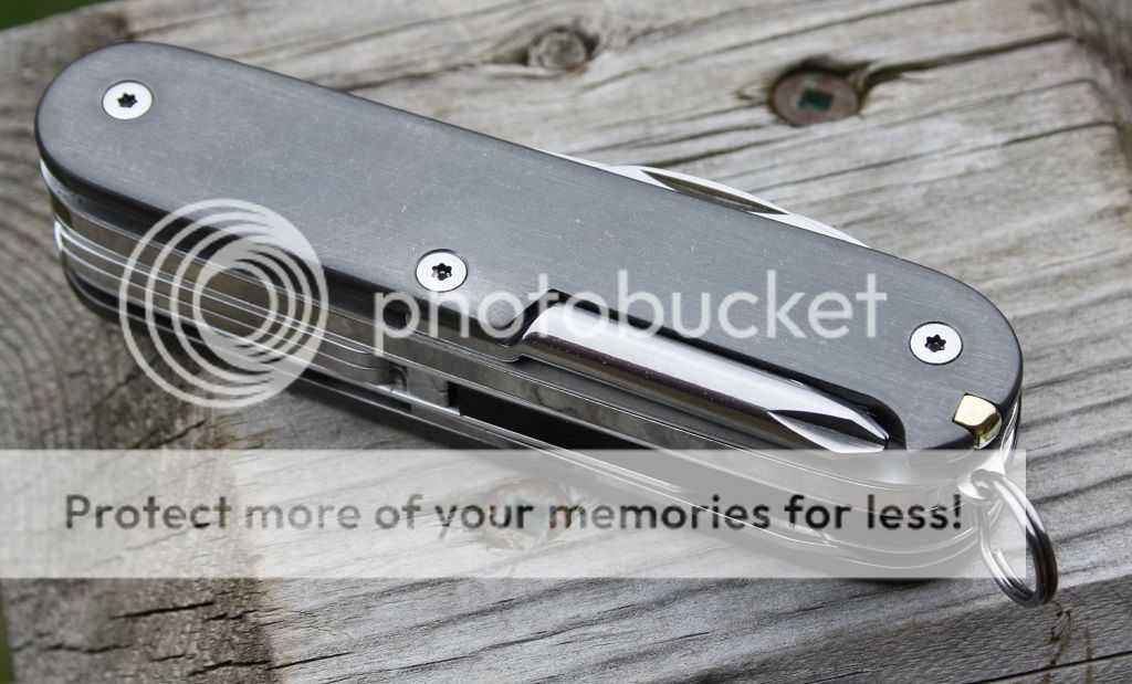

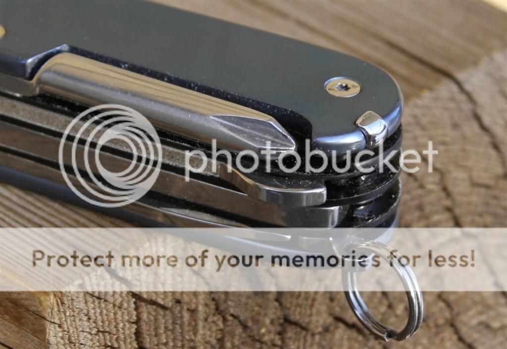

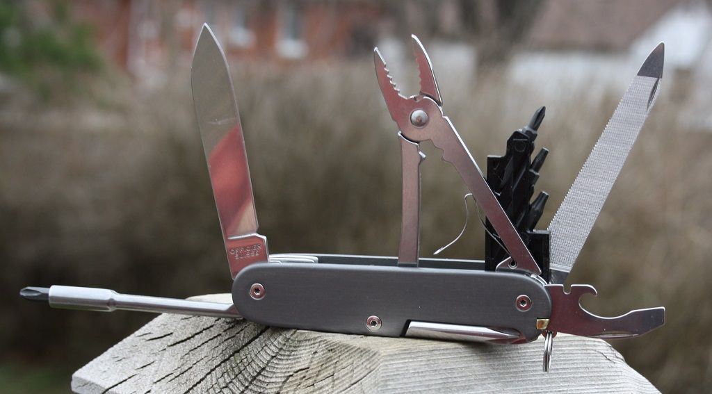

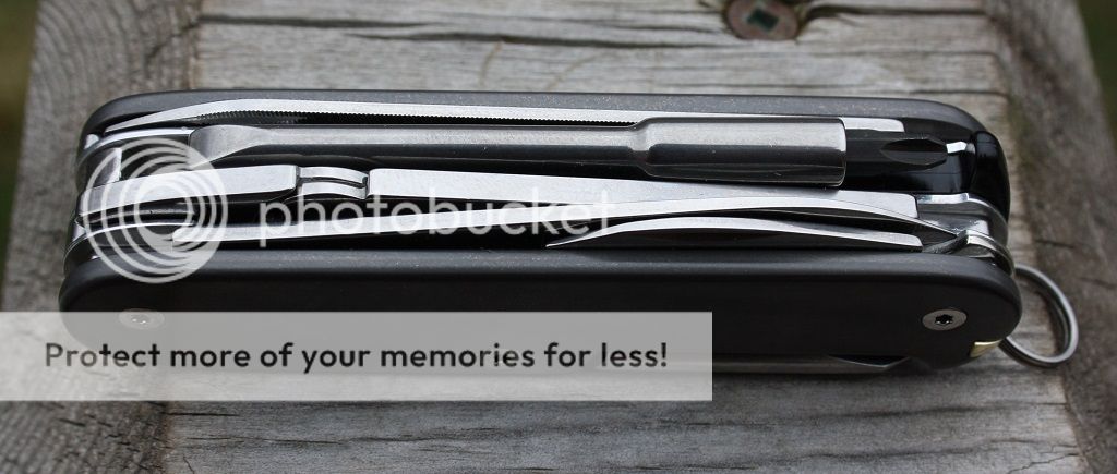

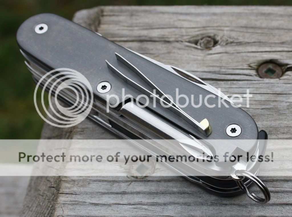

I have done a couple of cybertools actually. This one has matte natural finish Ti scales, with brass handled tweezers.
I have sold some parts before like liners and some scales. I'd sell the Ti blanks for 91s, but they still take a pile of work to finish up by hand. Round edges etc. The backsprings I make arent finished until the knife is finished. I purposely make them oversize, so what I do is temporarily assemble the SAK, then grind that homemade spring flush, then finish all springs the same way so they look as stock as possible. That and the cost to produce them is the main reason I dont sell them as parts.

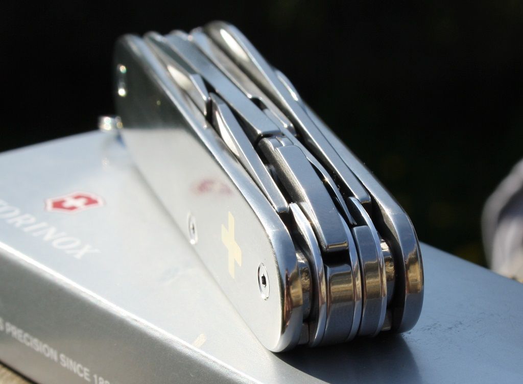

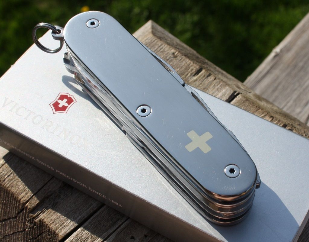

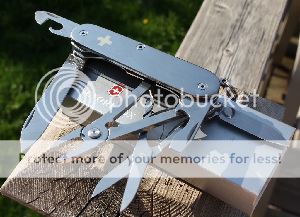

While I'm posting here is my latest Ti mod and my current favorite. Polished Ti 91mm scales with inlaid brass cross. :D
