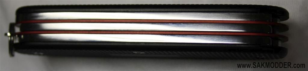

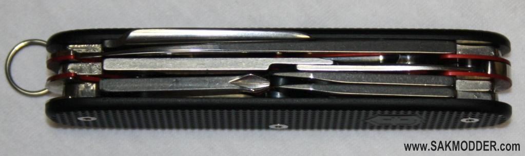

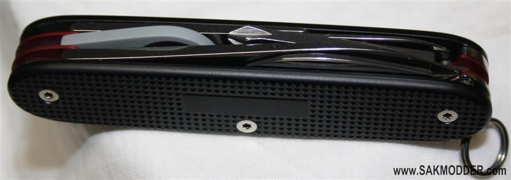

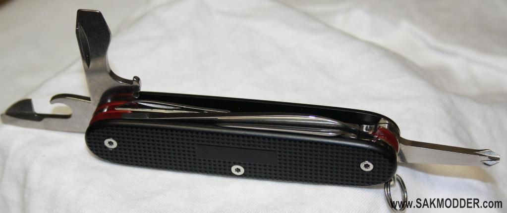

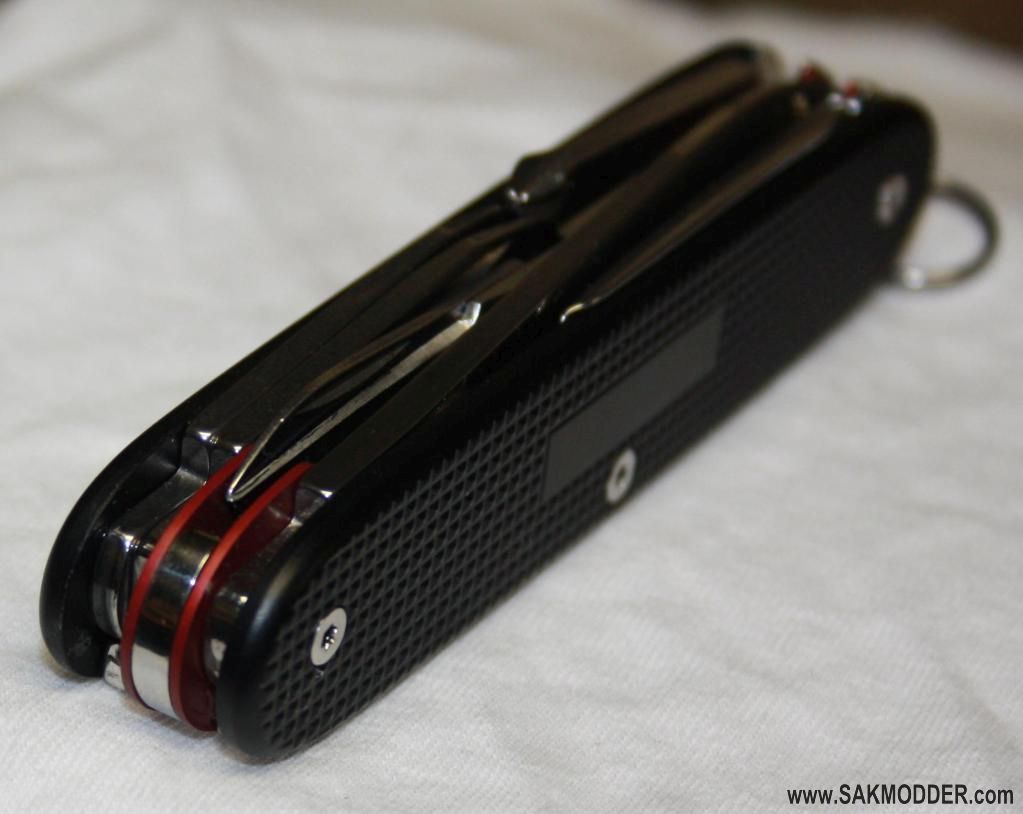

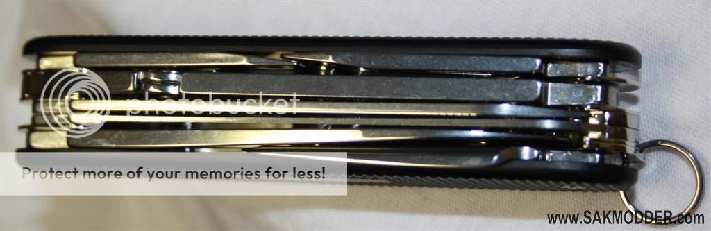

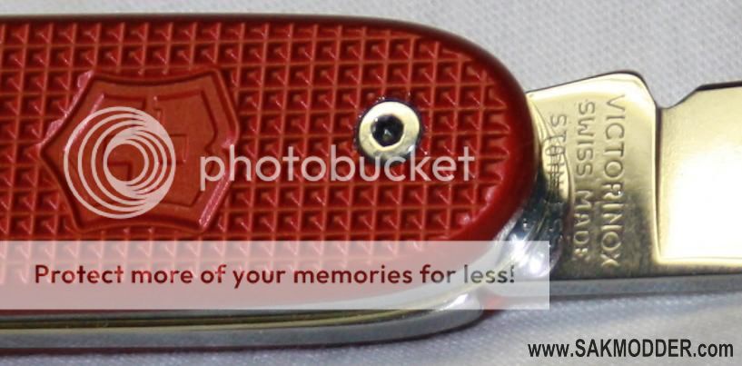

Here is one I finished up tonight. The can opener and bottle opener can fit opposite the philips driver with a dual spring backspring. It works out well and both nail nicks are accessible, which also allows plenty of clearance between the philips driver and scales.
Yeah, that red and black is right up my alley.

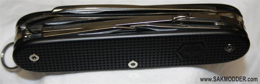

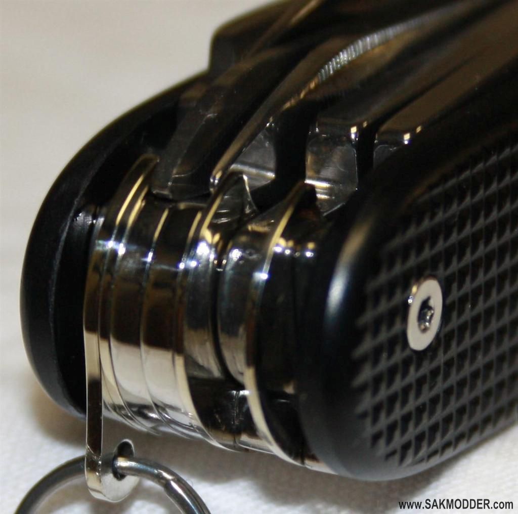

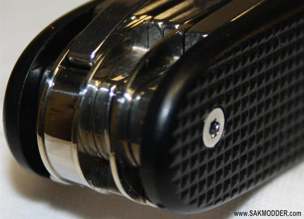

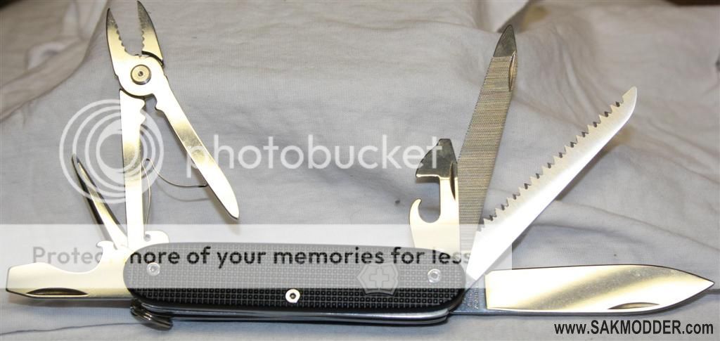

Here is the latest custom I finished tonight by request. I don't have a good name for it, but I've been calling it a big boy farmer since it's a 5 layer!
This is a HAIII scaled farmer plus metal saw and pliers. It is big, but since the extra saw layer is thin, it doesn't feel as big as I thought it would.
I know this thread has alot of pics already, but I always tend to take lots to try to show all the angles.

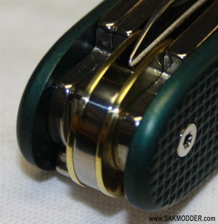

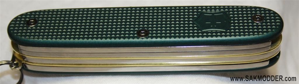

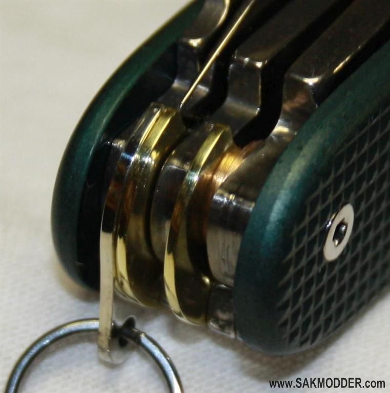

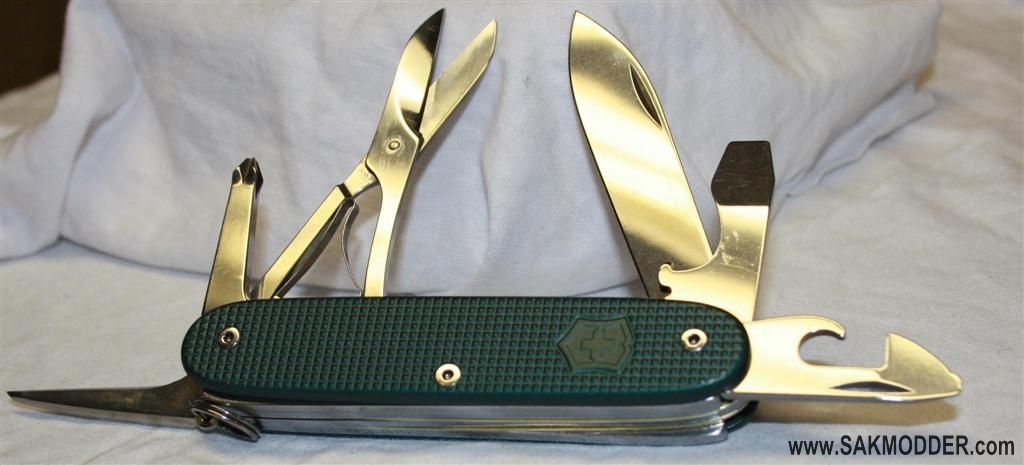

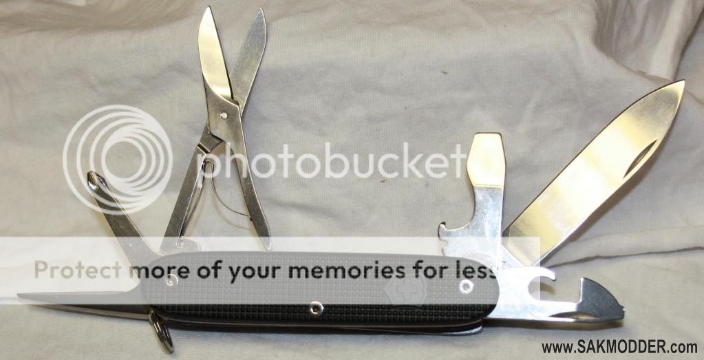

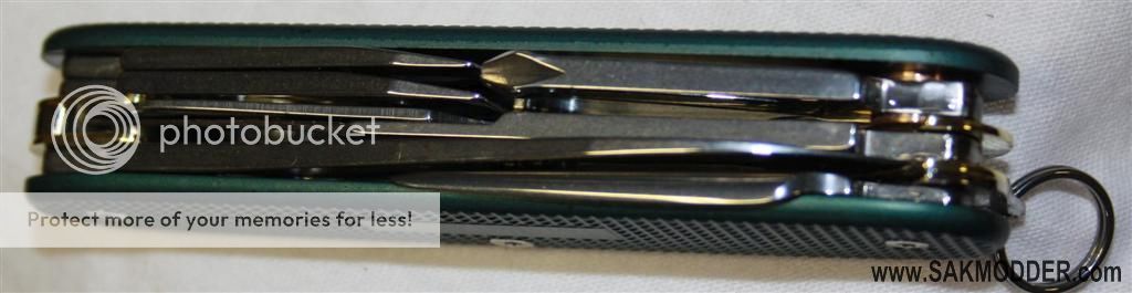

The Phillips driver opposite the two opener tools in one layer is quickly becoming the newest popular request. I really like it. Here it is again in green scales and c260 cartridge brass liners.

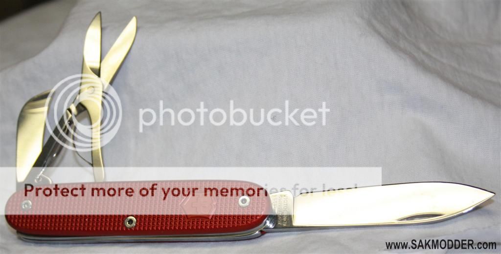

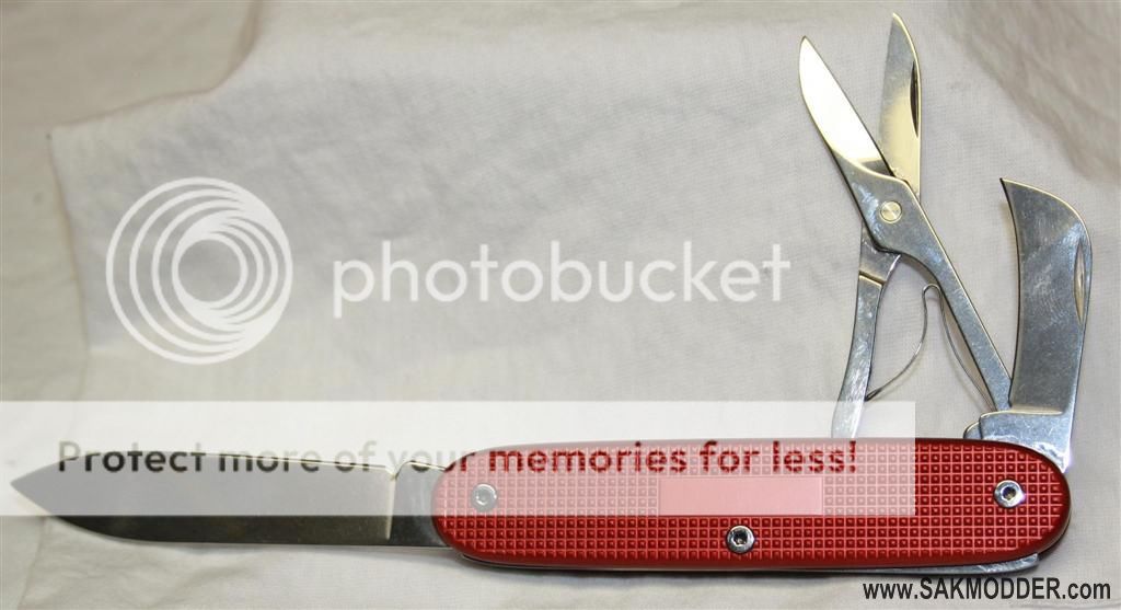

Here is a nice little 2 layer I finished up tonight. Pruner blade with main blade, and scissors. :D

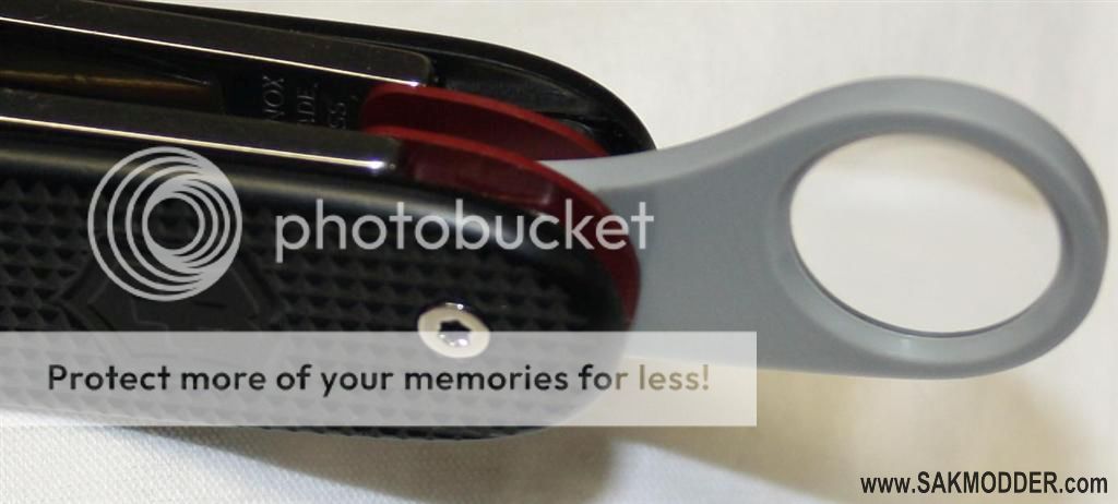

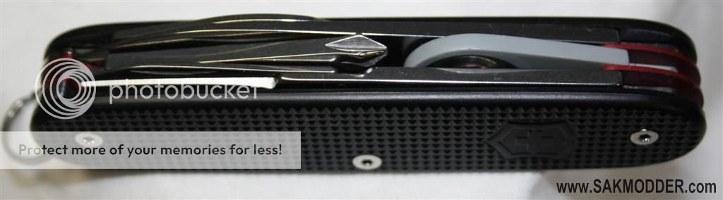

Here is another red liner and black scaled mod. This is the first time I've ever put in the magnifying glass. I'm not a big fan of the plastic parts, but it looks decent enough I think. :thumbup:
