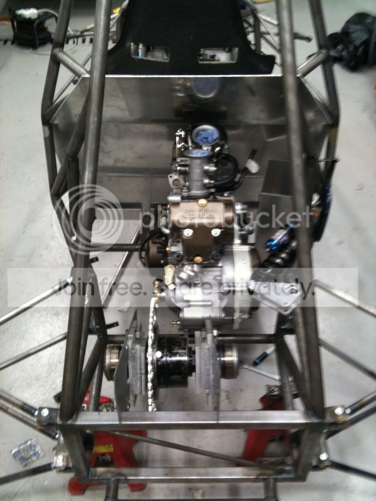

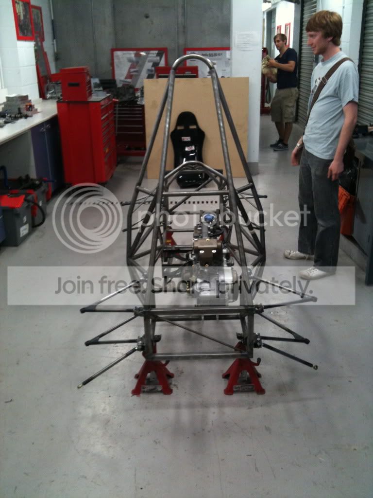

heres a few pics of the car at the moment, it still needs lots of work before july the 13th when we go to silverstone! Though tomorrow, we get out uprights, hubs, driveshafts, wheels and chassis back from the cnc place and the powdercoaters so assembly can begin.
