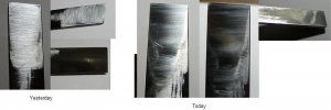

The D8-EE appears to need some break-in duties.
When I first used one, I worked the back of a chisel that already had a mirror finish. The first set show after the D8-EE.
I then used the D8-EE to lap some stones, and worked a few knives on it. Also tried different amounts of pressure. More pressure seems to work better.
The 2nd set of pictures show the results. Not perfect, but better. (The 2 sets of pictures are combined in this post).
As a side note, lapping finer stones on it was not good.... the stones basically stick together.
I think once the stone gets properly broken in, it will do a fine job (no pun intended... well maybe).
