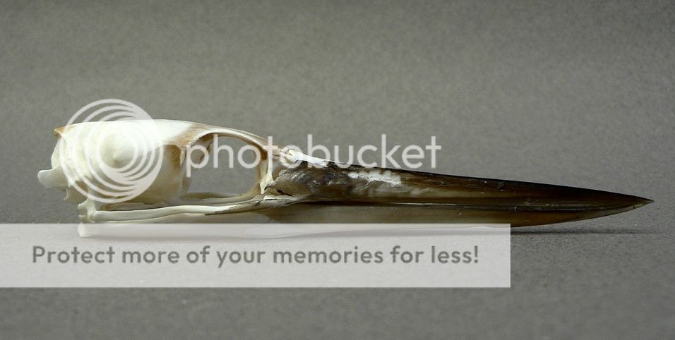

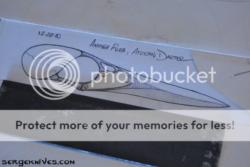

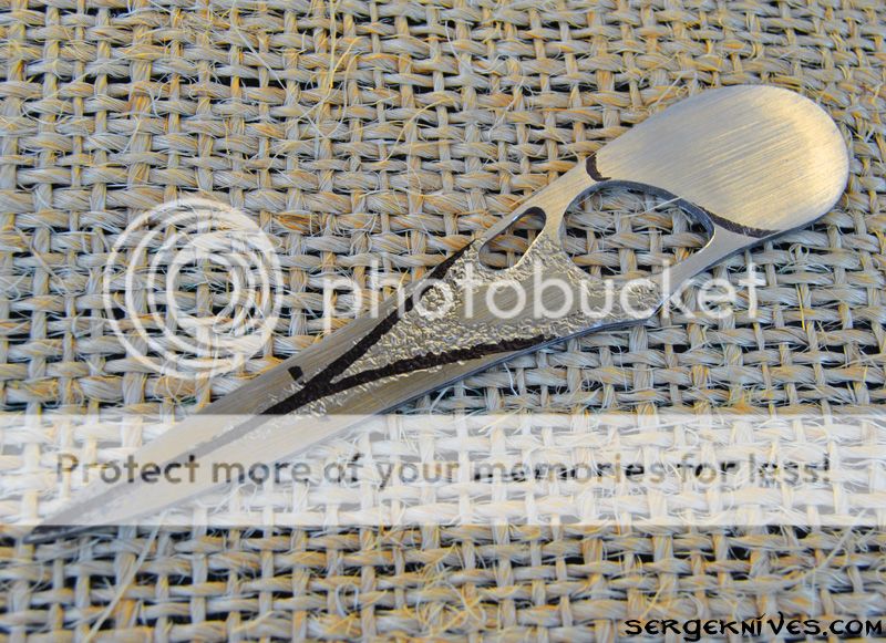

Hey guys, I'll do another WIP knife, this time a push dagger. This one is inspired by Virgil Englands work, he has been my favorite maker for a long time. This dagger is based on a skull of a bird called "African Darter", see pic below (photo copied from skullsite.com). The steel is 1080 and the overall length is 6".

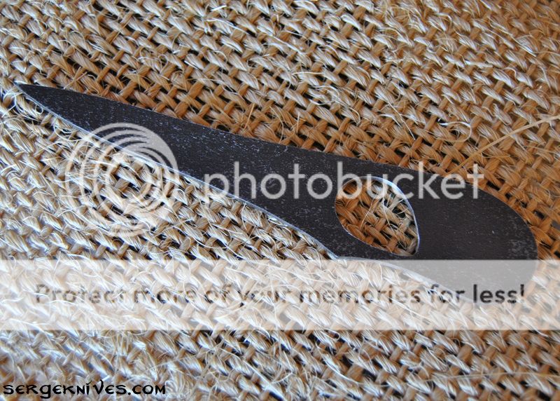

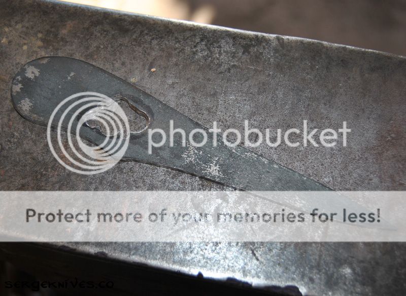

Starting to cut out the eye socket.
Eye socket complete.
Nose hole finished.

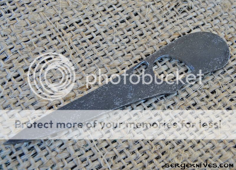

Textured and ready for bevels.

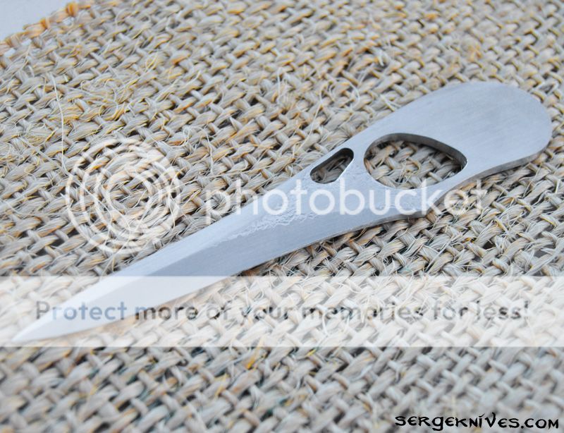

Thanks:) Here's where I am now..

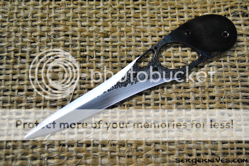

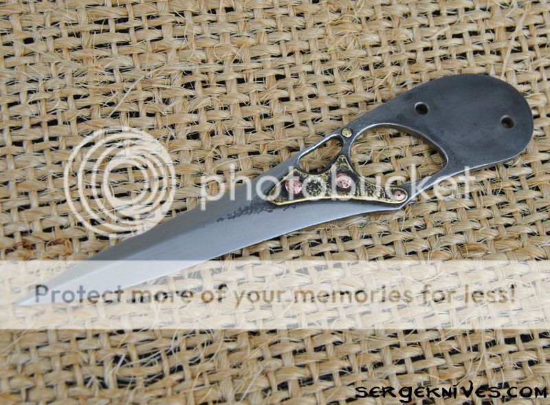

Bevels ground and handrubbed.

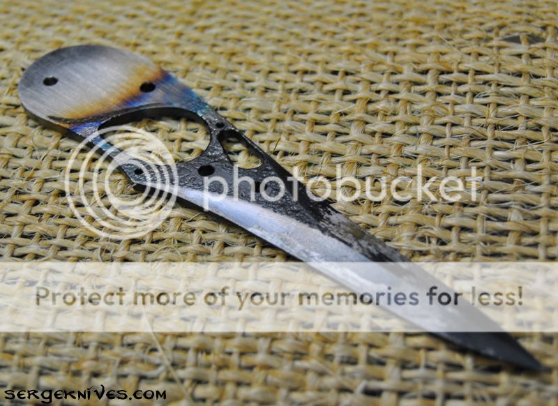

Heat treated.
Beginning clean up.
More tomorrow.
John, texturing is done with a carbide burr. Todays work:

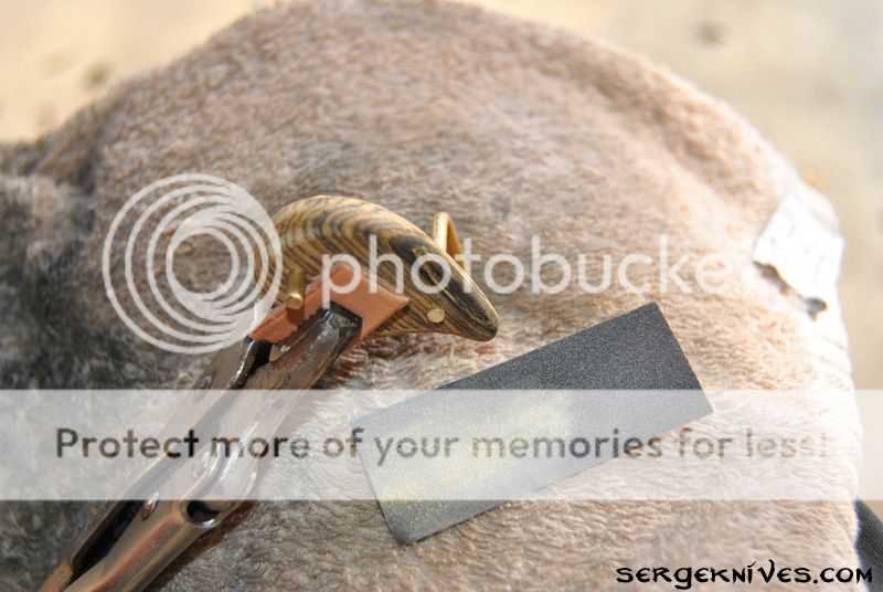

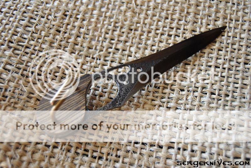

Profiled the Bocote handle scales.
Sanding and contouring the scales.
Scales are ready for gluing.
More tomorrow.

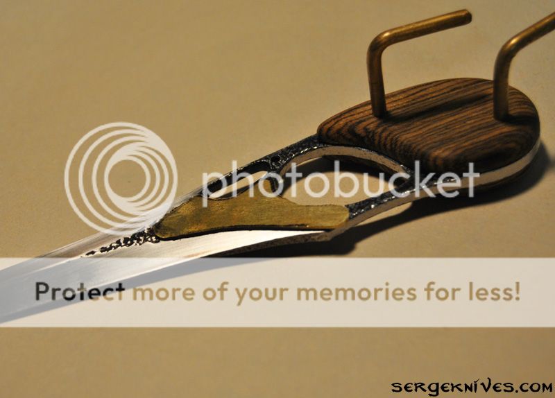

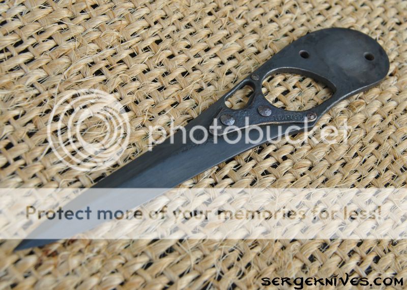

Todays work..Beggining to shape the brass plates.
The handle is fitted, brass plates are textured and fitted, the blade spine and all around the handle scales texturing complete.
I'll be gluing up the handle tomorrow.

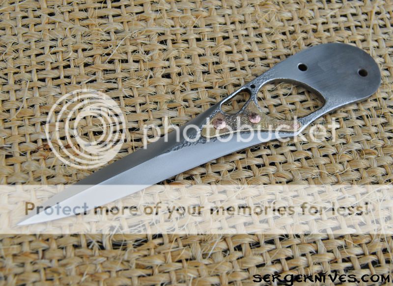

Todays progress... The brass plates have been pinned on.
Beginning to patinate.
Blade is 100% complete, handle needs to be glued on (already done).
I think I just need one more morning to complete it, so tomorrow the dagger should be done:)

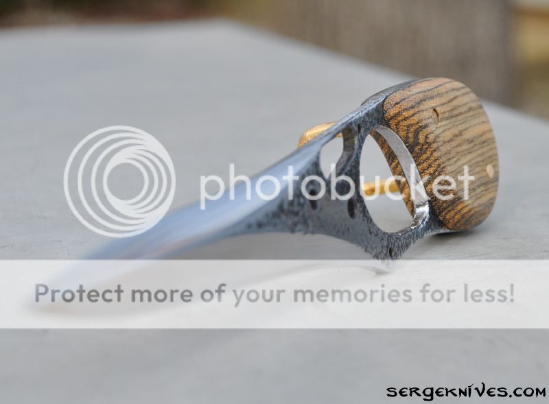

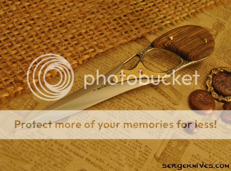

Thanks! The Darter Push Dagger is finished. I still need to make a stand for it, hopefully in the next day or so. This one was time consuming, but I think it came out well. I'll be starting another project soon, I'll try to make it a WIP as well. Thanks for all who were following this thread, and I hope you guys enjoyed it!
