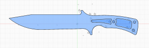

It's only an idea at this point, which I drew up in the last hour or two, in response to being asked what I could come up with that would compare favorable with the RMJ Combat Africa.
Mine is similar blade shape, except with a subtle swell toward the belly and about an inch more blade to give it some extra oomf in the chop. Not sure what the RMJ tang looks like under the scales, but I designed this one skeletonized so it can chop above it weight class due to the blank's forward balance. Depending on customer requests, between grinding and handle configuration I should be able to move the balance point anywhere from a couple inches ahead of the guard, to just ahead of the forefinger groove. Probably looking at 1/4" stock for the "lead pipe" effect. Kind of a bear to grind, but once I get it to near zero and put a newsprint slicing edge on, it will be beautiful and terrifying.
The guard is set up to allow a less cramped saber grip than what the Combat Africa looks to allow from the pics I have seen, while also locking the hand in better on account of the pronounced swell. This would take either lightweight materials like wood, Micarta, or Grip-Tec™ with sculpted coke bottley scales, or perhaps heavier and flatter materials like smooth or textured Suretouch, or textured G10.
Scales would fully cover the guard in a straight line so that sheath mating can be accomplished by grabbing the scale material, and the primary grind, as a result would, be diagonal, parallel with the edge of the scales. Also this would add comfort to the saber grip in that your thumb is pushing against not only the tang thumb ramp, but also the scale material, which will be well chamfered. It can be done with a crowned spine, a sharp spine, and with sharpened, unsharpened or no swedge.
And it didn't have a name, but since you asked while I was working on this, why not call it that.
