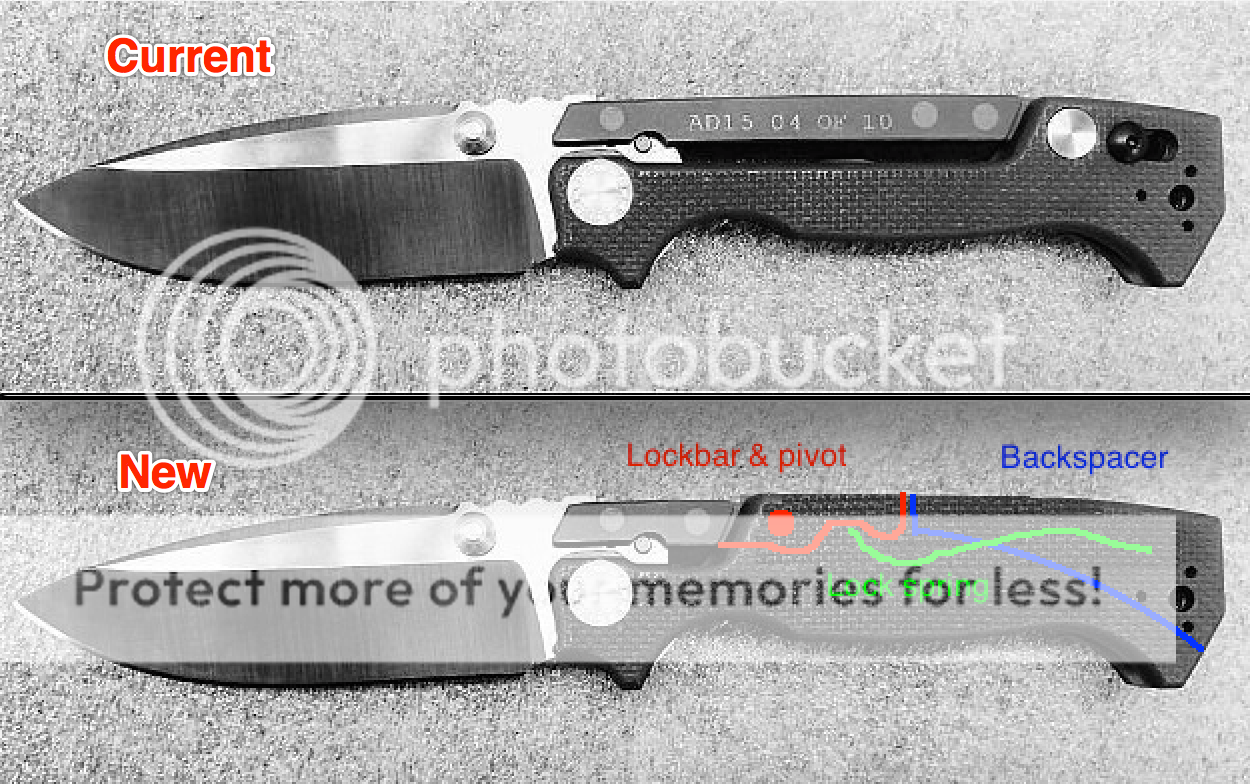

I love the design of the Triad & Scorpion lock. I've been following Demko's Instagram as well as some youtube reviews of the AD-15. While it's a big improvement over the triad lock in terms of ease of use, I personally feel like the closing action of the current design seems a little bit awkward. E.g. the Scorpion lock bar extends all the way to the end of the handle and you may have to open up your palm when closing the knife.
I've had an idea on the improvement ever since i saw this lock, and i figured i would draw it up and share it here hopefully Mr. Demko can see it. My idea is to move the pivot of the Scorpion lock bar forward to the front of the handle while using the traditional backlock/triadlock backspacer spring to provide tension to the lockbar. This basically turns the design into a hybrid of the Scorpion & Triad lock. It also resembles the old Tiger Claw thumbstud triad lock design that didn't go into production.
The benefit of this design is that you will now be able to close the knife with just your thumb without opening your palm, very much like a vertical axis lock. You can also move the pivot point further forward/backward depending on the strength/ergonomic requirement, very much like how the triad lockbar's position changes between models. I believe it's easier/cheaper to make as you do not need to mill the complicated titanium backspacer attached to the lockbar.
One disadvantage i can think of is that it will no longer be an open construction like the Scorpion lock. Also, the benefit of the Scorpion lock, being an open construction is that the blade can sit deeper in the handle which means less footprint when closed, while the proposed design will be more like triad lock. However i believe it still preserves the better blade to handle ratio.
Here is the diagram:
Please let me know if it's a good idea. Really hope that CS/Demko will give it a shot and see how it works.

Really interesting idea, but wouldn't that more traditional spring/backspacer occupy more space in the handle and prevent the closed knife from being quite so slim?
You would likely make the lock vastly more difficult to close. Longer lever = less force needed to lift the lock. Your design would reduce the length of the lever by about 2/3rds which would hugely reduce the leverage working for you.

Yeah, that was one of the potential disadvantage i pointed out. But i think they can try to move the design of the backspacer & spring around to maximize the space.
I dont really mind the closed width of the knife, as wider knife is actually more comfortable to carry in the back pocket(how i carry my knife 90% of the time). What's important is that it still preserve the better blade to handle ratio vs the triad lock.
It may increase the tension but i think it's depends on multiple factors such as the placement of the pivot(fulcrum in this case) & the spring, as well as the spring tension itself. Even at the same position illustrated in the pic, i think the tension is still much less than the triad lockbar as triad lock's cutout are usually much closer to the fulcrum. The lever here is still much longer than on the standard triad lock, since it's on the opposite direction.

That can be an option. I experimented with many different variations of the scorpion lock, especially the length of the top half of the frame, and drive springs. In fact the first designs were very similar to what you drew as it's most similar to a lock back or triad, then evolved to what you see now. thank you for your interest in my work

Thanks for jumping in Mr Demko! Yeah based on the old Tiger Claw prototype i thought you must have tried the front release mechanism on the Scorpion lock as well. You mentioned that the first designs were similar to the drawing, what was the reason for moving away from it? Just curious since you have the first hand experience in testing it, is it because the release tension is too high or that it took too much space in the handle?

The main reason was there is not much room for the lock pivot and spring. I wanted the blade to set deeply in the handle when closed and use a large pivot for the yoke. Also it is nice to have the yoke (upper frame ) longer so the grip can reinforce the lock up.

Hmm that makes sense. I saw your width comparison of AD15 vs triad lock when closed, definitely a big difference. Oh well, there are always trade offs. Another benefit i can think of is that, with the shorter yoke, you can potentially use steel instead of titanium, which would increase the strength while not gaining significant amount weight. Also the aluminum backspacer would offset the extra weight. Not sure how significant this is tho, since you did mention before that the lock usually fail at the pivot area where it can shear off from the handle.
