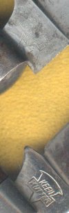

I have these two pruners with KeenKutter tang stamps, the top one having the name E.C.SIMMONDS across the top of the logo. I assume the "Simmons" is the older. There are also subtle differences in construction.
I have these two pruners with KeenKutter tang stamps, the top one having the word SIMMONDS across the top of the logo. I assume the "Simmons" is the older. There are also subtle differences in construction.
View attachment 1188693 View attachment 1188694 View attachment 1188695
Mate,your collection of cutlery just absolutely staggers me. I know you have been collecting for a long time, but still, absolutely amazing. Keep posting pics., i am sure everyone loves them as much as i do. Have a great day.:)
Chaysons, your KK was made sometime after 1940, for Shapleigh Hardware. The "ears" at the top of the tang stamp are one indication of Camillus manufacture. The shape of the spey blade also is indicative of a Camillus made knife, however, Camillus made knives usually had a K preceding the pattern number stamp? That pattern number is not listed in Sellens guide to Keen Kutters, however, the only catalogs put out by Shapleigh were in 1940, 1942 and 1958, so your knife was likely made sometime between 1942 and 1958.
Beautiful stock knife, Jolipapa!:thumbsup: Sellens says that particular shield was first used in 1942, so it would have been made sometime between 1942 and 1959, when Shapleigh went out of business. It would appear to be a Camillus made knife, based on the shape of the spey blade. That beautiful bone also looks like some of the Rogers? bone used by Camillus, to my eyes anyway. I have no idea why there is no tang stamp?
Beautiful pair of pruners, Charlie!:thumbsup::thumbsup: You are correct, the EC Simmons is earlier, pre 1940 for sure and I my guess would be early 1920s or earlier. To me, the older Walden made knives often have a very distinctive shape of the curve up to the kick, but I could be full of pickled porcupine :poop: on that one? The other pruner was made post 1940 for Shapleigh, possibly by Camillus from the ears at the top of the tang stamp.
