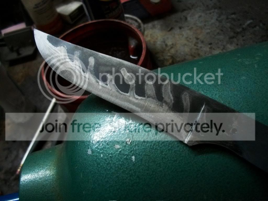

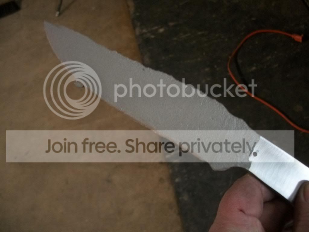

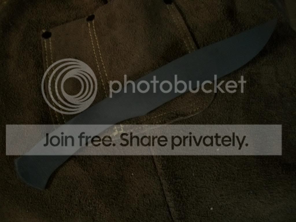

Well i did a couple damascus recurve double grind knives here latley, They drew some attention,So i figured id do one in 1095 and try to get a nice hamon on it,I did a flat grind on this one so the hamon would show well if it turns out,if not we will try again!so here we go
Step #1

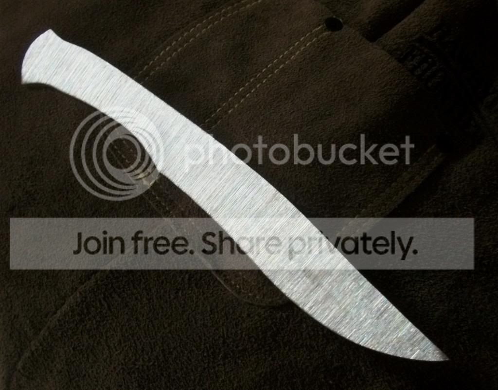

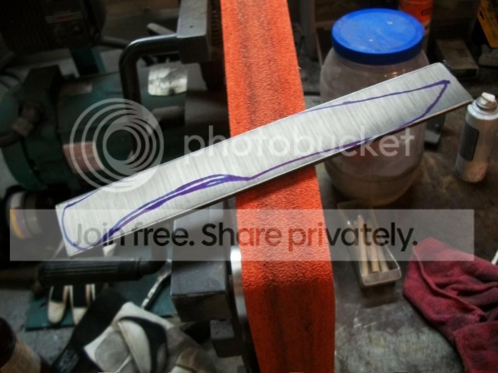

Aldo's 1095 / 5/32" Flat stock
Stock removed

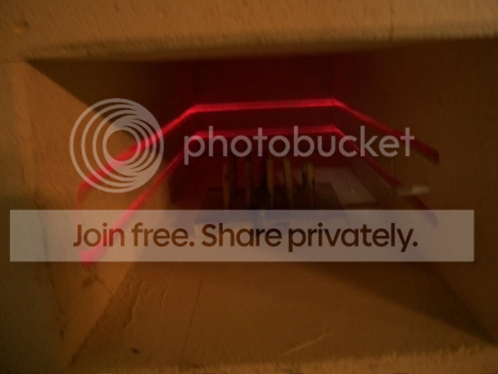

Into the forge for normalization 4 times for me

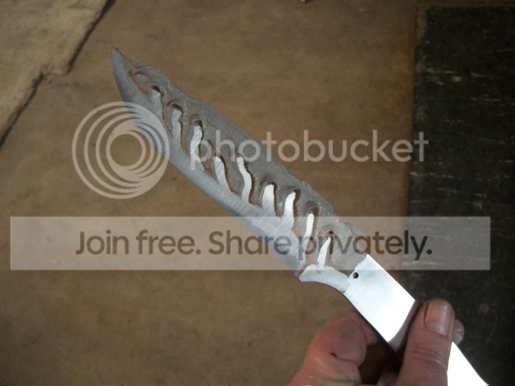

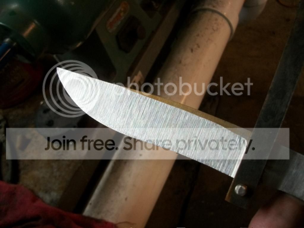

Remove the scale

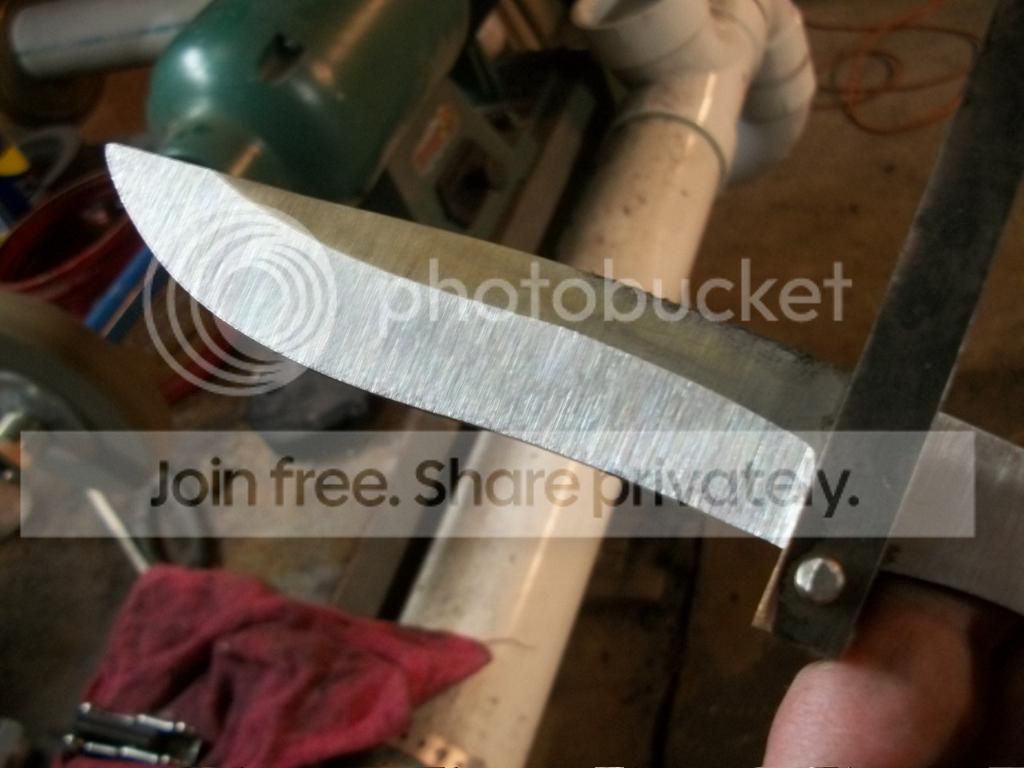

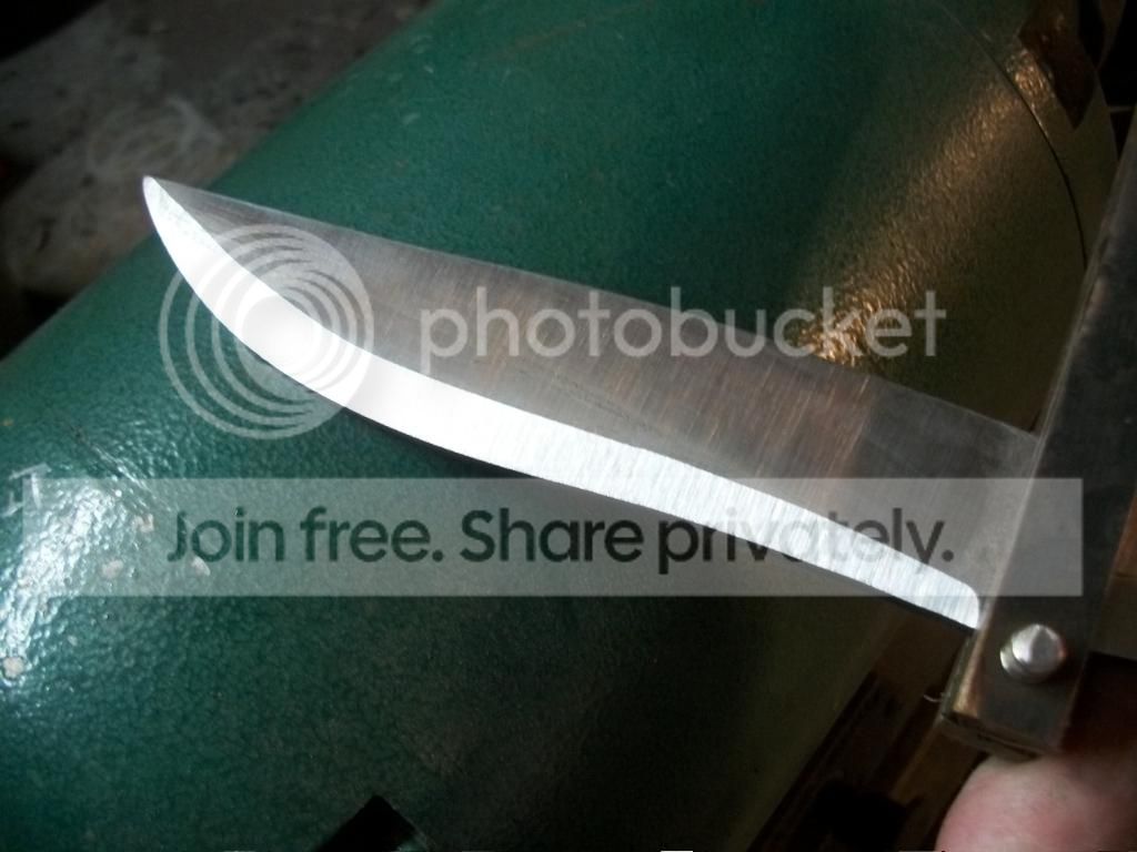

Starting my grind

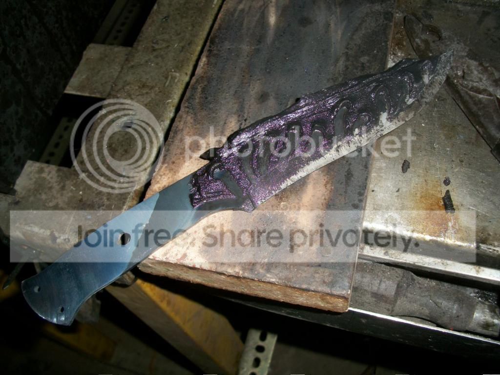

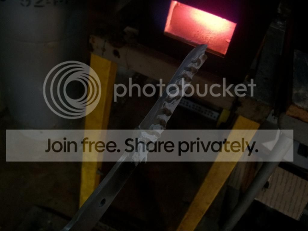

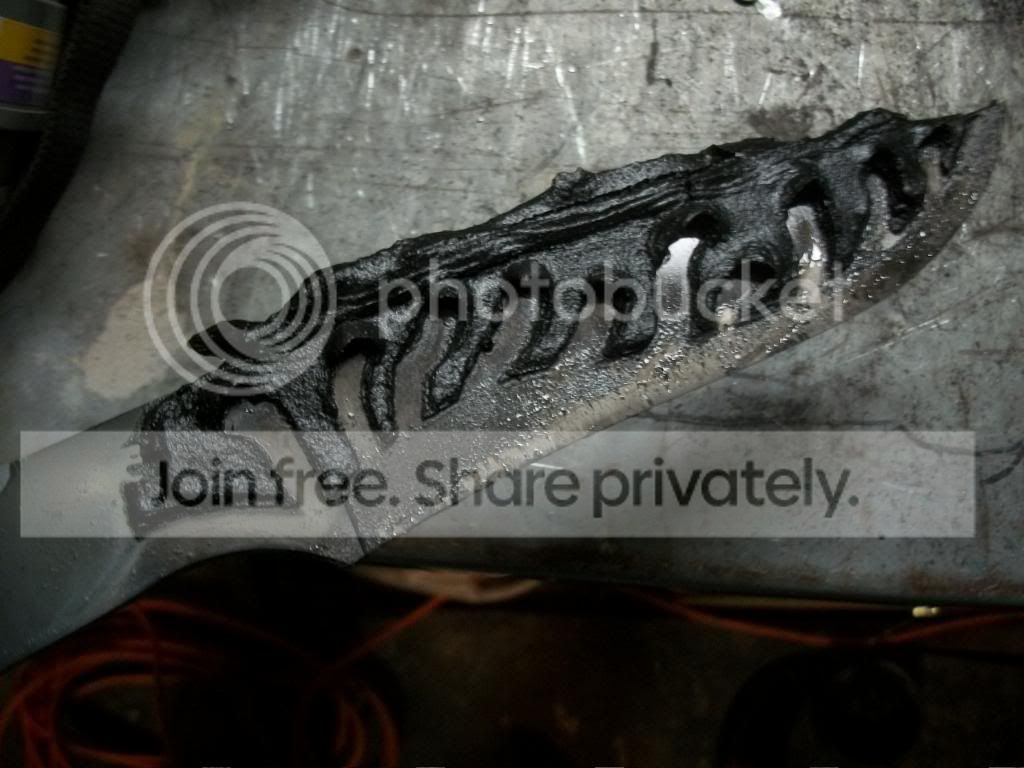

Time for the clay coat to process a hamon

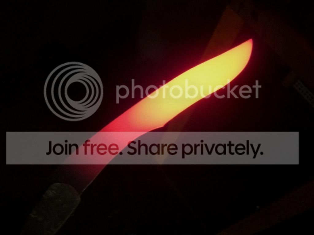

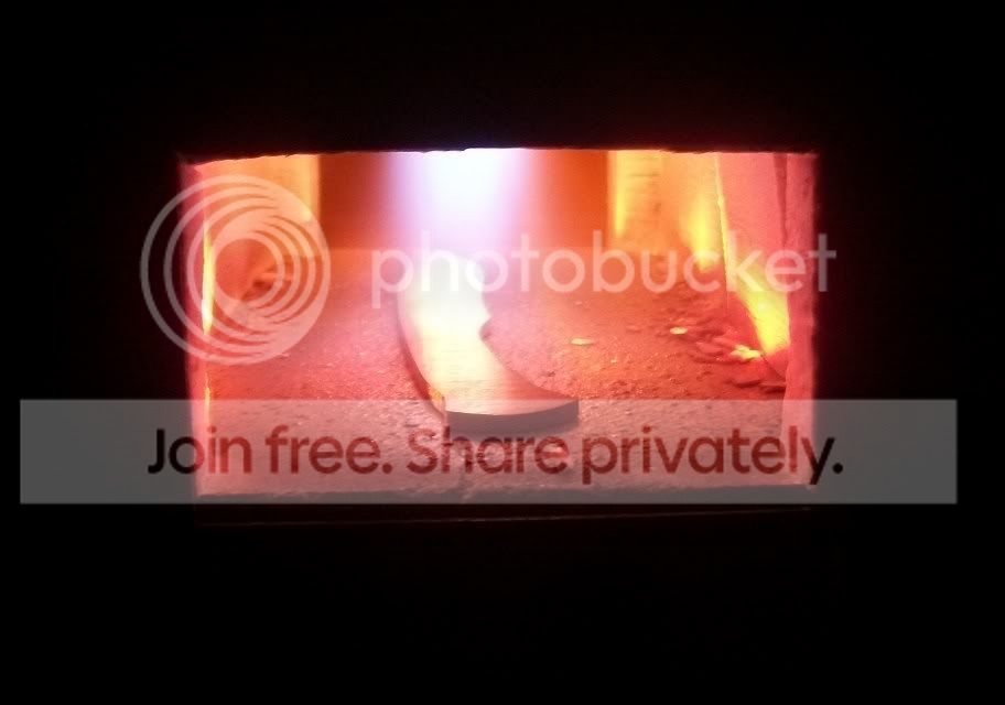

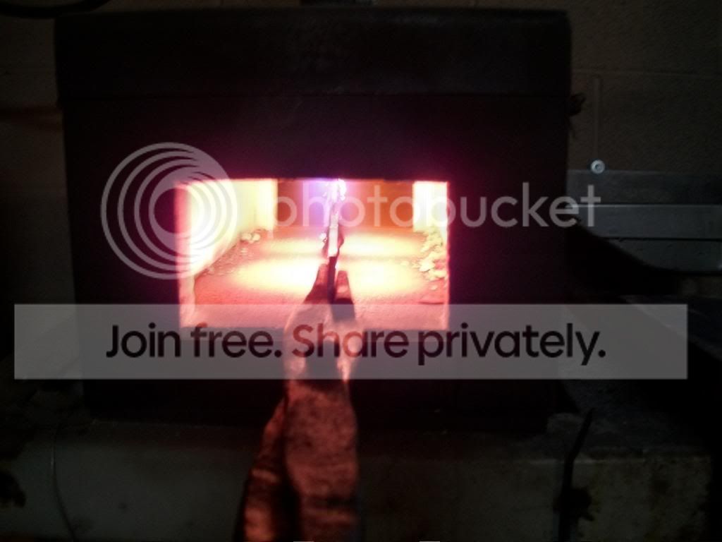

Time to go in the forge and bring the blade up to temp for quenching,in we go !

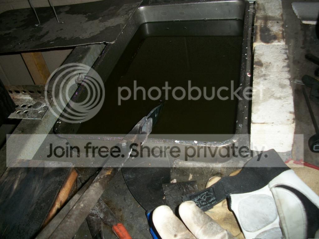

Quench time

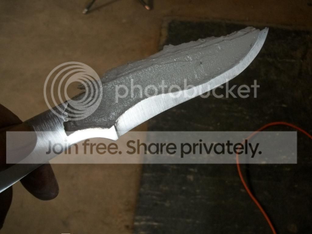

After the quench,clay stuck well
Off comes the clay??

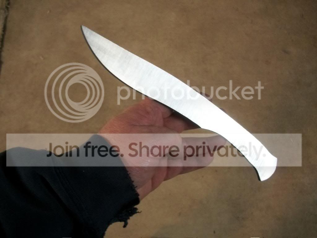

Into h/t oven for a dbl temper at 400degrees for 1 hr each
