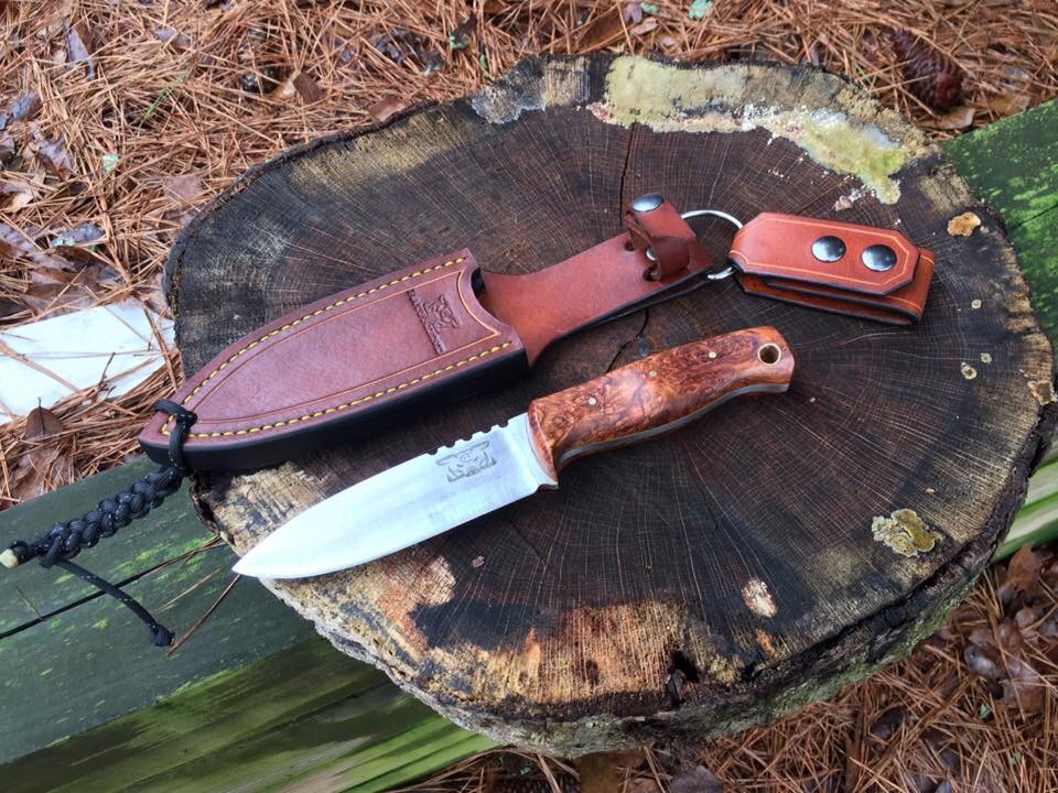

Okay so I've had my evenheat kiln for about 3 or four months now and I'm finding I get very mixed results with the heat treat.
I finally thought I was beginning to dial in on my process and get all issues worked out and just went to do a couple of simple product tests and BOOM! Broke the tip off of two! Now before I destroy the others I would like some insight on how I can redo the HT and get the results I'm looking for.
Here's what I've been doing...
Using 01 tool, 3/16" thick, I grind out my blanks, drill pin/lanyard holes, and flat grind bevels down to around .02-.03" at the edge.
-Apply Brownells antiscale coating
-Place in the evenheat at 1300 degrees soaking for 20 min.
-Remove and allow to air cool to handling temp
-remove residual antiscale and reapply fresh coat
-Return to kiln and ramp at full speed again to 1300 and soak for 10 minutes.
-Ramp at 75% speed to 1490 and soak for 15 minutes
-Remove and quench in 130-150 degree preheated canola oil ensuring blade goes into the oil straight with edge facing down and applying slight agitation in an up-down motion only.
-remove and hang up to further cool while the kiln cools to around 200 degrees.
-once kiln has cooled, place blades back in and run a temper cycle at 400 degrees for 2 hours.
-remove blades and hang to cool in still air.
-repeat 2 hour temper cycle at 400 degrees.
I always test the blade tips by stabbing into pine and trying to pry out a piece of wood... Not deep, maybe .25" or so. And on average about 50% are snapping, and it's pissing me off like crazy!
Am I just grinding my tips too thin or what? I just feel like they should be bending more before snapping like that. Please help!

Thanks for the reply. I haven't tried the higher temp temper cycle, as I'm trying to keep it around 60-61 Hrc, but I can give it a shot. I'm using a good size ammo can for my oil container with about 1.5 gal of oil and the quench method of tip down is how I do it.
As far as not testing the tip like that, is there a better way? I feel like as the most vulnerable part of the knife it should be tested. I really don't want to sell it and have an unhappy customer when it breaks. And I feel like I've seen plenty of makers successfully test their tips like this. As a general purpose/woods knife it should be able to handle this.
Here's a pic of the knife I'm making. Again, it's 3/16" 01 tool with a 5" blade and 10.5" overall.
Also you might want to try taking O1 to 59c instead of 60-61

The tip should be tested for its use. The temper should be done for the use. The knife you show is for a filed/camp/hunting use. These don't need or want to be of high edge hardness.
O-1 is a tough steel, but not the best for higher hardness. It should be in the Rc-58-59 range for best toughness vs edge retention. The thin tips will easily break at Rc61 but will be dozens of times tougher at Rc 59.
For some reason the idea has been spread that at a 400F temper steel becomes soft. A quick perusal of the temper charts for most of the popular knife steels shows that they are still above RC60 at 400F, and usually still at or above Rc 58 at 450F. A 350F temper is just going to remove a little brittleness, but do no toughening at all in most cases.
I suspect if you thickened the tip and do the temper for a Rc59 target ( 450F temper) the tips will do well and the overall knife will be better.

A little update here, I have settled on 465 for my temper set point and I'm very happy with those results. The color of the steel was a perfect straw color and Edge retention was great cutting cardboard and leather during my tests.
