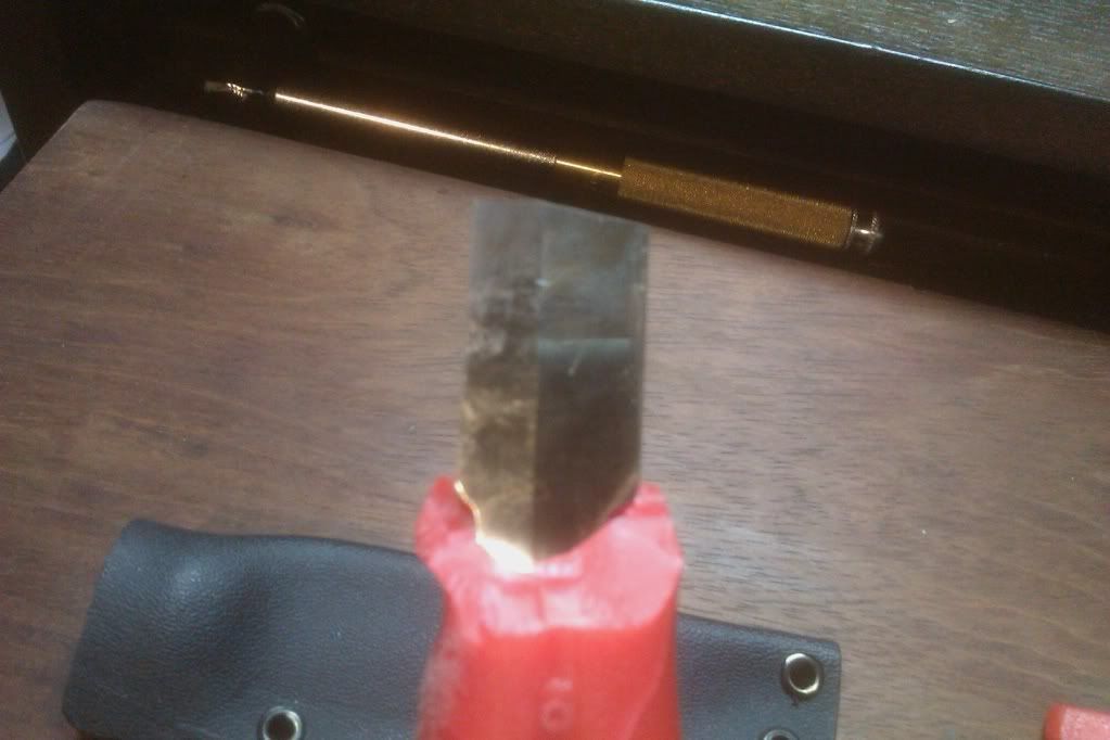

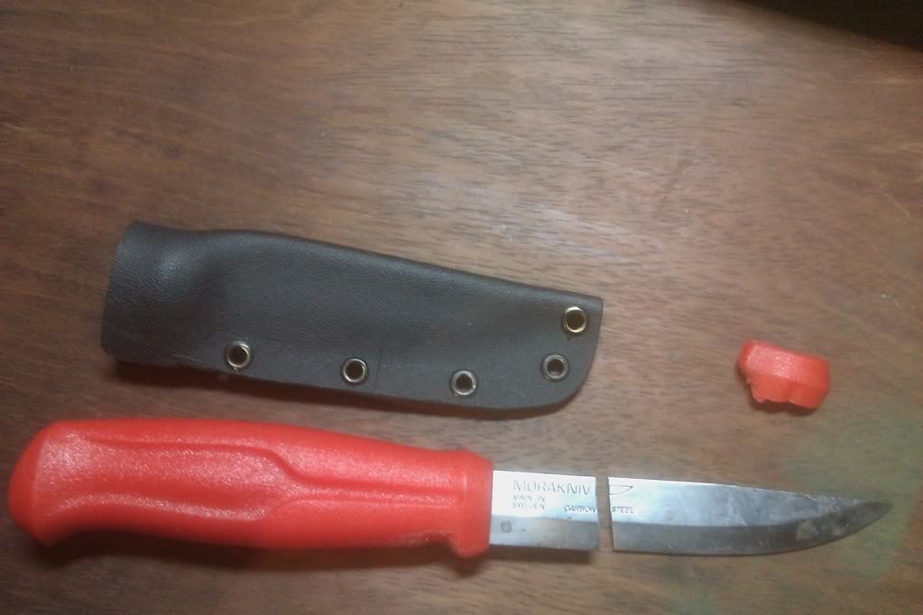

So today I had it on me. I was using it to split some oak for another spoon,
being as gentle as possible with the thin blade, scandi grind and stick tang.

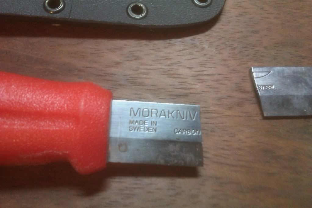

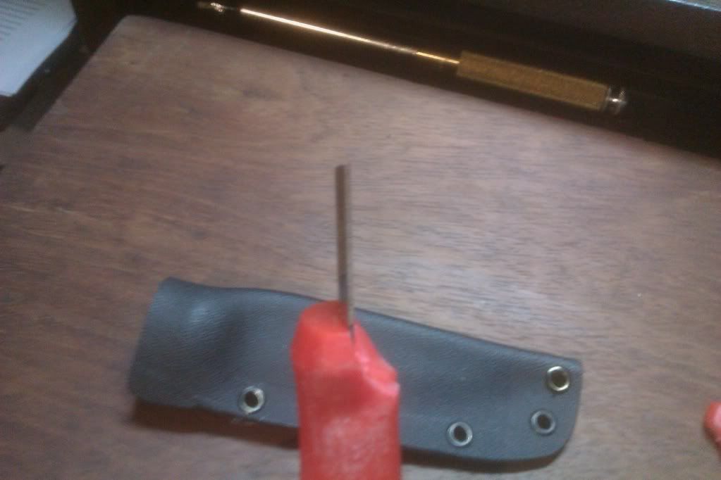

Into literally a minute of use, it catastrophically failed, sending half of the blade one way,
while the other half bent back and shot a piece of the handle off.
Another tiny shard came off of the second part of the blade, rocketing through
the air and finally bouncing off my eyebrow, I am extremely lucky it did not hit
any lower or get imbedded, it just left a scratch.
Overall it was a great knife, I am not upset that it failed, probably my fault
somehow, but it could have been a fault in QC.

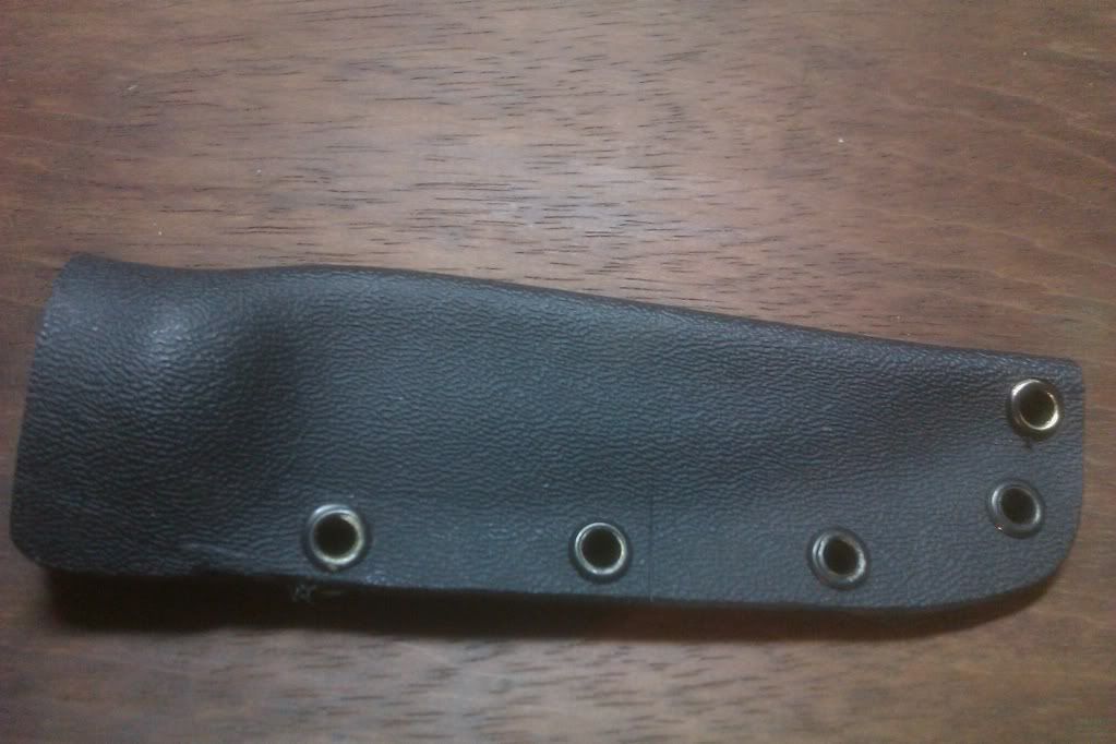

However, I am pissed after the hour I spent perfecting the handle, making
sure it fit just right. And, when I get another one, the kydex sheath I made
for it will not fit the new knife, even after trimming the handle.

By the way, this is what it looks like
