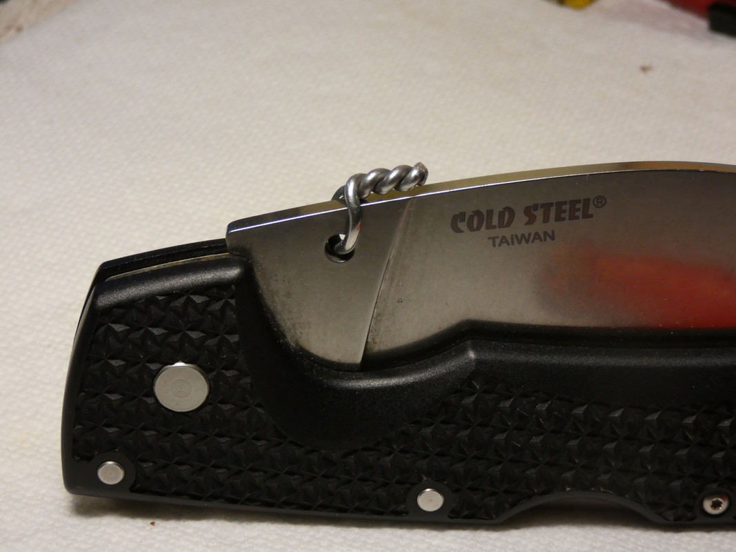

You could always mod to wave open . Either buy a "Snaggletooth " or DIY .
My EDC has a simple twisted wire opener :
Talwar has a thumb plate for waving already. OP said it works fine, just hard to roll it open.
