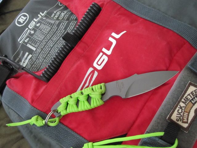

Ive owned and used MISSION Beta Ti knives for a good many years and am very happy.
As Mecha touched upon, ti knives have a bad rep amongst most knife owners/afficionados.
When ti became all the rage, scrupulous knife makers made knives of any old ti about, as most quickly found out, that Beta ti is hard to work.
Some of these inferious ti knives will not cut butter on a hot summer day and has also been touched upon, many knives touted as being Beta are in fact not.
Mission is the only one or amongst the few making 'mass produced' knives, who are able to work Beta ti (not counting custom makers like Mecha here of course).
My old Mission knives are super strong, ergonomics are great and they are impervious to the elements.
My knives will zip through several deer and will hold a working edge for a perfectly adequate time.
One knife (the MPU) does double duty for a minimalist camping/hunting knife and for when kayaking.
Just leave the knife in the vest and rinse the rig after use in salt water.
Seems there are not a lot of people using these excellent knives, which is sad, as they will work just fine.
I could not be more happy with my Mission knives in any event.
Great knives which I heartedly recommend.
