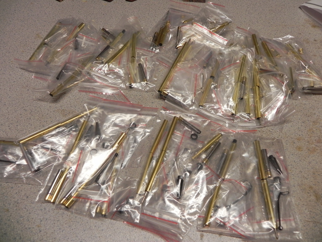

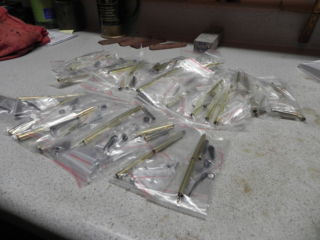

I think wildman put a spell on me or something. I got a few pen kits today in the mail.
30 to be exact. This should keep me busy for quite a spell between other things.
Now I got the stuff and the desire, just need the time and the energy.

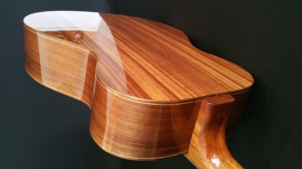

From Wikipedia:
French polishing is a wood finishing technique that results in a very high gloss surface, with a deep colour.... French polishing consists of applying many thin coats of shellac dissolved in denatured alcohol using a rubbing pad lubricated with one of a variety of oils.​
An example:
The subject is not without controversy. Many people swear by French polish because that's what was used on classical guitars and high-end furniture way back when, like in the days of Sr. Stradivarius. However, some say that French polish was the best that they had back then, but some modern polishes are just as good and you can finish a project before you die of old age.
Also, French polish is not the most durable finish, hence questionable for objects (or parts of objects) that are handled a lot.
Personally I have done extreme high polish, but not French polish. One reason is that I like high polish, but not high gloss. Another reason is that life is short. :)
For a very small project, like a pen, French polish might be a little less strenuous, but if you actually plan to write with it, the finish might not be durable enough.

I've been finishing my turnings with Friction Polish. It's essentially French Polishing. It's Shellac, Alcohol and Boiled Linseed Oil. I've heard you can make it food grade by dissolving Shellac flakes in Food grade Alcohol, then mixing that with 100% pure Linseed or Tung oil. Supposedly they are safe for Wood Salad bowls. Mineral oil is food safe, I use it on my wood utensils, but it doesn't react to the Shellac and Alcohol properly.
French Polish or Friction Polish looks dang good! Might not be the strongest finish, but it's still nice. I think I'll apply a Polyurethane sealer to items that need to be water repellent.
Dang right its controversial because it take weeks to do it right. Like Heber says "Life Is Short" so you really must want to learn it real bad! Shellac cut with Alcohol usually 1-2 pound mix ratio. I havent heard of mixing linseed oil with it but im new to it so that makes sense. Some wax over french polish to make it more durable. Some mix pumice in the pad on the first few rubs then on the next few hundred rubs I suppose it just wears into the wood and takes a polish. The results are pretty astounding and the Masters charge a pretty penny or should I say a few Krugerrands to do it. If you got a 5 million dollar Stradivari or a curved spine then I guess it dont matter to ya because youll pay it anyway. Im thinking a pen would polish pretty well on the lathe. Take it off and it might take some time? Do a search on The Tube and you'll see how involved it is. French polish over checkered surface...impossible i say!
The Friction Polish only takes a minute or two to dry between coats. I apply a coat to the turning while its spinning on the lathe on a low speed, let it soak in and spin for a minute. Then I apply another coat and allow to dry. Sand, then apply another coat. 4 to 6 applications with sanding in between makes for a pretty finish on the wood. May take pictures this weekend of the process, if I have time and help.
Wax over the top of friction polish is recommended. Ten wax is what a few local shops use. I'm going to try that soon.
