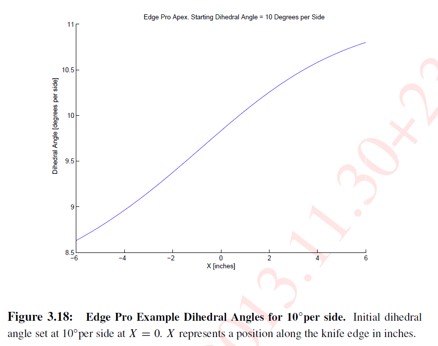

I've performed a very detailed mathematical analysis of the Edge Pro Apex (EP-Apex) and also the Wicked Edge Precision Sharpener (WEPS). I wanted to share the results with the general knife community.
As someone who loves mechanisms, I wondered if there are any ways to improve the EP or WEPS. Of course one could improve the precision of the EP and WEPS mechanisms with more accurate parts machined to a finer tolerance, etc.
However, after careful thinking, I realized that even if these mechanisms were _perfectly_ precise and _infinitely rigid_, that they would not always grind a perfect dihedral angle (informally known as a "V-edge"). That is, if we used a perfect EP or WEPS to sharpen a tanto knife, then the knife edge would not have a perfectly uniform dihedral angle. There will be a tiny variation in the included angle of the knife bevel.
How big is this variation in angle? To study it, I coded a computer program calculate the geometry and have written up the results here.
Topics in the report include:
(1) Tiny variations in sharpening angle in the Edge Pro Apex and also the Wicked Edge Precision Sharpener.
(2) A detailed analysis of the "Stop-Collar Trick" and how it is an approximation.
(3) For WEPS sharpening, a discussion about where to clamp the knife so that the sharpening angle is as uniform as possible over the entire knife edge.
(4) Using belt sanders to sharpen V-edges.
To pique your interest, here are some figures and one animation from the technical report.

Please note: the slight variation in sharpening angle is VERY SMALL. In fact, it is typically around 0.1 degrees or less. In the worst case that is plausibly realistic, it is at most 0.5 degrees. In the Sample Figures above, we only really care when the sharpening stone is close to position X=0 inches, that is -1" <= X <= +1". These TINY changes in sharpening angle are virtually undetectable in practice.

Hi Officer's Match,
This is true; by frequently adjusting the knife position, the sharpening stone will remain close to the "center line" of the knife platform. That will reduce the deviation in sharpening angle. And then if you over-lap strokes, the deviation will simply give you a slight convexing of the knife bevel, which is by no means a bad thing. :)
I think the most realistic worst-case is when you might try to sharpen a knife at 10 degrees per side. Yes, that is very very thin. But suppose you wanted to do that? Here is the graph for 10 degrees per side (see below). Since we are keeping the sharpening stone near the center-line of the knife platform, we are only interested in the graph for -1" <= X <= +1" (that is, when the center of the sharpening stone is within +/- 1 inch from the center line of the platform). From this, you can see a maximum variation of around 0.4 degrees away from 10 degrees per side.
Looking at the graph, maybe -0.4 to +0.05 degrees. I think this is as extreme as it gets for any example that is still realistic in practice. Probably does not matter in practice, but interesting I hope.
btw, this result is specifically for the Edge Pro Apex which has a more steeply inclined knife platform (about 30 degrees). For the Edge Pro Professional, the knife platform is more shallowly inclined (maybe 15 degrees), and would give different results. I haven't run the calculation, but for the Edge Pro Professional, my guess is the deviations would shrink by roughly a factor of 2x (for our example of sharpening a knife at 10 degrees per side).

Actually, if you work through the geometry, I think the variation is huge for 90 degrees per side! The variation gets smaller close to 30 degrees per side, since the Edge Pro Apex has a 30 degree inclination for the main platform. As you move away from 30 degrees per side, the variation gets larger. I'm not sure, but I think the variation maxes out just before 30+90 = 120 degrees per side, but I'm not sure; very weird things happen when the sliding rod is (almost) parallel to the vertical mast. Not that sharpening at 90 deg per side or more makes any sense! :D
btw, for the Edge Pro Professional, the main platform is inclined at 15 degrees. So for the EP-Pro, if you sharpen close to 15 degrees per side, there is no variation. But as you sharpen at angles different from 15 degrees, then you get more variation.
