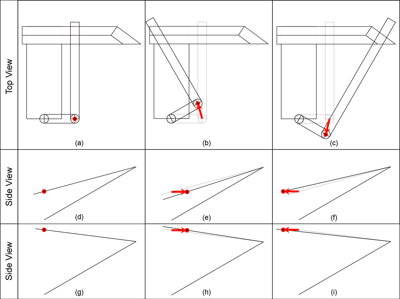

Okay, now we come to another interesting question. How does the asymmetry of the EP-Apex affect the sharpening angle? In the report, please have a look at animated Figure 2.3 and also animated Figure 3.11. I have uploaded them to YouTube here:
Figure 2.3.
https://www.youtube.com/watch?v=Lg3dK_n49Gw
Figure 3.11.
You may need to view this in full-screen HD to see all the details.
https://www.youtube.com/watch?v=xtY-TTwuT2M
I'll assume that you've read through the part of the report which describes Figure 3.11. So let me consider an EP-Apex with _exaggerated_ geometry, namely we make the pin too long (as shown in Figure 3.11). For simplicity, let's consider a top view and a side view.
In panel (a), we are looking top-down onto an EP-Apex where the pin has been unnaturally lengthened. The large rectangle on the left is a top-down view of the main-platform for the EP-Apex, and the circle at the bottom-center of the rectangle represents the vertical-mast. The thin tall rectangle represents the sliding-arm. The red and black dot represents the connection between the pin and the sliding-arm. Panel (d) is a side view of (a) where we have only drawn the dihedral angle for sharpening. The lower-side of the angle represents a side-view of the knife, and the upper-side of the angle represents the sharpening stone (or sliding arm).
In panel (b), we move the sharpening stone to the left. This causes the vertical mast to perform a counter-clockwise rotation. As you can see, this pushes the marked dot closer to the knife edge. In panel (e) we have a side view that shows the counter-clockwise rotation moves the marked point horizontally closer to the knife edge. As you can see, in this case we are decreasing the included angle.
In panel (c), we move the sharpening stone to the right. Once again, this causes the vertical mast to rotate, but in the clockwise direction. The side view (f) shows that this clockwise rotation moves the marked point horizontally away from the knife edge. The resulting included angle is increased.
In our panels (d),(e), and (f) we are illustrating the case where our sharpening angle is less that 30 degrees per side. The EP-Apex has a main platform that is inclined at 30 degrees.
Suppose we try to sharpen at more than 30 degrees per side. What happens? This is illustrated in the side views (g), (h), and (i). As you can see, we get horizontal displacements that change the sharpening angle. However, now the relationship is flipped. Moving the sharpening stone to the left causes an increase in sharpening angle (not a decrease). And moving the stone to the right cases a decrease in sharpening angle (not an increase).
This flip in relationship between stone position and sharpening angle occurs at 30 degrees per side, and is clearly shown in the graphs of the report. For example, let's consider sharpening at 15 degrees per side, and 40 degrees per side. In the following images, I may have reversed which side I placed the sliding-rod on. So the side where the angle is increased (or decreased) may be reversed. However, you can see the relationship flips as one graph is increasing while the other is decreasing.

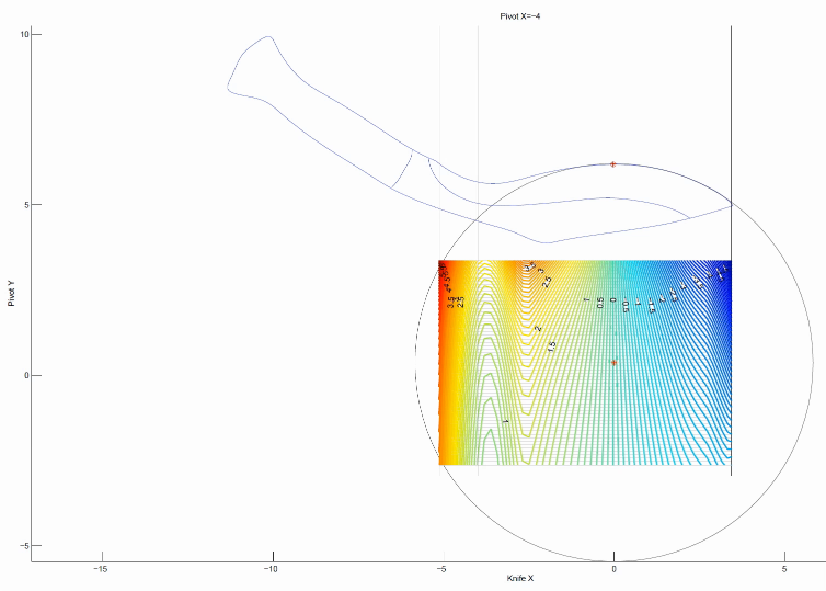

I'm back from the holidays and had a chance to do some visualizations.
So, let me mention what kind of data we're trying to visualize:
Suppose we have a Chef's knife that we want to sharpen on a WEPS-Gen2. Where should we clamp the knife to minimize the variation in sharpening angle?
What we could do, is try lots of different clamping arrangements and see how each one varies the sharpening angle, and then somehow graph or plot all the results. So what does this data look like? To find out, let us go through an example in full detail.
For those of you who are TL;DR, just skip to the bottom of this post to see the visualizations without any explanation. If that seems sufficiently interesting, then you can come back to read the explanations below.
So, say I want to sharpen the chefs knife at 15 degrees per side. I'll pick a point on the knife edge that I want to be exactly 15 deg per side; this point is our _calibration point_ on the knife edge. Next, I need to try many different positions for the spherical joint in the WEPS-Gen2. I can specify the position by (x,y) coordinates where (x,y) are coordinates in the plane of the knife. The z-coordinate is perpendicular to the plane of the knife, and it is adjusted until we get 15 deg per side exactly at our calibration point. Now our knife and WEPS-Gen2 are fully set up. Finally, we get a sharpening angle for each point along the knife edge.
Given the above, we have the following:
Let x = x-coordinate of the spherical joint.
Let y = y-coordinate of the spherical joint.
Let x_knife = x-coordinate of a point on the knife edge.
Let f = sharpening angle (degrees per side) at some specific point.
So our data looks like this:
f(x,y,x_knife) = sharpening angle on the knife edge at point x_knife, when the spherical pivot is at (x,y), and z is adjusted to sharpen at 15 deg per side at our calibration point.
Now we have a problem: How to visualize f(x,y,x_knife)? To fully plot this, I need three inputs and one output, which would be... four dimensions. Sadly, we only live in 3 spatial dimensions, so I can't do that. In fact, I only have a computer-screen which is 2 dimensions. So how to go from 4 dimensions down to 2?
I'll try to solve this with two techniques:
