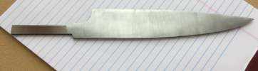

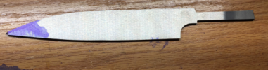

Fredy - here are some photos - still in process of course. the stock is ~3.5mm thick (taken from specs from posted commercial knives) the bevel was pre-ground (one sided) down to 0.02" per agreement with JT prior to HT. the steel is "Spicy White " (26C3), tempered to 64 rockwell (hence the partial grinding prior to HT).
I need to finish the grind on that side down to 0.007 or so (still dont have the courage to go below that for fear of burning the edge), and try to clean up the shinogi, (oh, and correct the overall profile of the spine, which is off a little) then turn to the other side for the ura:
I have long wanted a Yanagiba, and this is kind of a trial-run for me - shorter than I would really want - but a chance for me to try out the steel, and the grinding techniques particular to this style. If I feel comfortable after completing this knife, I will start in on a longer one - I really want one as much as 300mm - as I do somewhat often make rice rolls, nigiri, and sashimi (though my wife only likes the veggie or pre-cooked meat rice rolls):
I've only now begun to feel like I have **barely** gotten the knack of slicing the sashimi correctly and of assembling the nagiri .... and the longer blades definitely make a difference in slicing the sashimi and in slicing the rice rolls.....

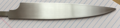

I promised some photos of this. Now that I got that glass platen done, I could return to finishing the bevels on that Yanagiba, and giving a try at grinding the urasuki.

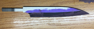

Bevels went ok .... reasonably good shinogi (but not perfect) .... a few imperfections that dont show up in this photo .... but overall I am pleased (edge is down to 0.006-0.007). I am, however, now faced with the question of whether to give it a go at vertical grinding to establish lengthwise grind marks, or to go to hand sanding to both clean things up and establish a lengthwise finish. prior attempts at vertical grinding has resulted in two burned edges .... so not sure if I have the courage for that.... (btw - that weird edge shape will be cleaned up during final profile/sharpening. This has been taken to A65 gator belt:
I was pleasantly surprised at how straightforward grinding the urasuki was. pretty easy to establish the grind down the middle of the back of the blade, pretty much like "feeling" the bevel in settling the curved belt back into the established curved urasuki .... and also not bad at all in working the grind upwards to the spine or downwards to the edge until the entire back side is ground. It helps that you are not really grinding at the very edge ... so heat is not as much of a problem....
here you should be able to see the curved gap produced....

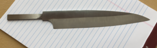

This is really kind of cool! If I do go to hand sanding, I will need to make one of Stacy's curved blocks to get down into the curvature. Not sure at all though how to follow Nick Wheeler's recommendation of sanding at alternating angles until you get to the final pull strokes.....
A block of hard foam will work fine for sanding the urasuki. Balsa wood sanded to match the curve also works well.

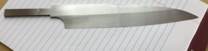

I did opt to hand sand ... I think I will leave it at 420, as this will be a working knife. I do like the lengthwise pulled finish .... and it holds up better during use than the spine-to-edge finish.
I'll wait for stacy to respond re. the type of foam to use (dont have a lot of that kicking around.....) then do the back side. should be a *little* easier .... as that side never saw anything below 120 grit while grinding (it was the leftover 60 grit marks on the flat bevel that gave me the most work....)
If the Styrofoam is firm, yes that will work. I was referring to a close cell foam, like a dense piece of memory foam or similar upholstery foam.
I missed the pic updates somehow, looking good! I would be tempted to do a satin finish on the flat part and high polish on the bevel. Or etch the flats and satin the bevel. What are your plans for the handle?
Stacy - turns out that a package that recently came had some small pieces of rather stiff foam (not closed .... but nice and stiff) - it worked really well! thanks :) I did need to do some focused "thumb pressure" work ... but not too bad. Here is what the result came out as:
