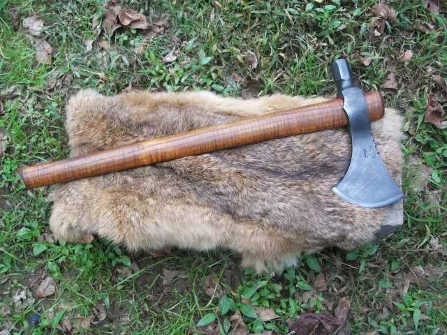

We use this method all the time to get that real aged patina on hawk/axe heads...The longer the etch the more drastic the appearance.. We sand to around 120-220 grit, clean the piece real well with degreaser then coat with cold bue...Then submerge in bleach...We leave ours in for 30min-1hour so any scratch marks from 120 grit and up are etched off and gone anyway.Clean up with a wire wheel..Though rememeber these are axe heads not knives..That long would be too drastic on thinner knives..
heres a couple of axes with a 1 hour etch..
