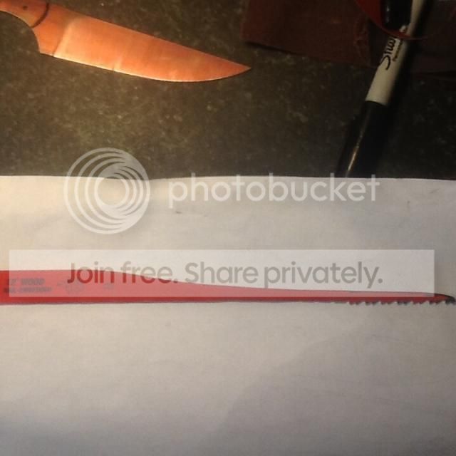

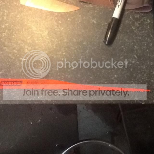

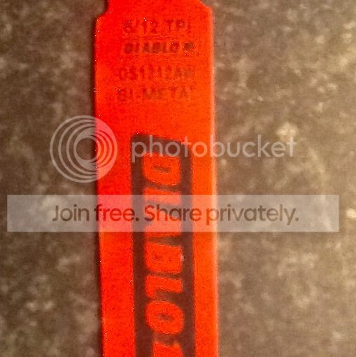

Well, I'm an idiot... I read the title but my brain registered reciprocating saw blade and not hacksaw blade... I decided to take a look at mine and took a few really lousy pics-sorry they're so grainy.
I took the blade and ground the majority of the teeth down as well as slimming down the profile at the nose so it would fit into smaller holes.

Well, I got the 10/14 tpi Diabolo blade(s) and am grinding it down just exactly as shown above, but I am silver soldering three together for rigidity, and a closer thickness of cut to finished product. Chews up some 36 grit belts to get to the right shape, will be done tomorrow.
