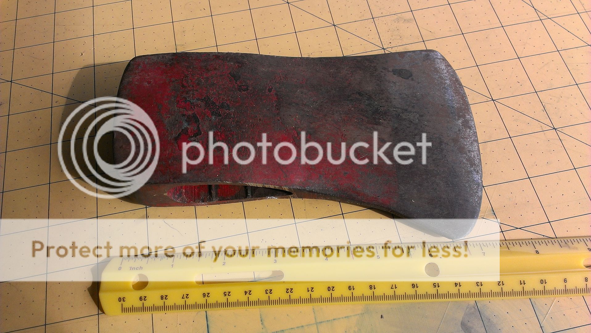

So I'm looking over a few double-bit axe heads and the majority I tend to find seem to be in this weight and around ~10" long. I'm curious as to what haft length would be best for this head weight. Would you require something longer like a 36" to make it balance properly or could you get away with a 32"? I'd ask about a 28", but I'm pretty sure those are definitely for lighter heads.
The reason I ask is because I'm about 5'4" and find the idea of a 36" handle to be off-putting for my size...

Well instead of starting up a new thread, I guess I'll just update this one.
Right now I'm in possession of a 2.5lb as well as a 3.5lb DB axe head. I'm also planning on getting a 3.5lb SB axe head...
Now, I've already decided that a 28" haft will be optimal for the 2.5lb DB as I want that to be a cruiser, but I'm still really torn on the 3.5lbers. I think it would be best to get the same length helves for them, just so my full sized axes are consistent and it's easier to switch between the two... but I'm really torn between 32" and 36" lengths. They'll be used for felling, limbing, bucking and maybe some splitting - and again, my height is 5'4" to put things in perspective. When measuring it out, if I were on top of a log bucking, it seems like the 36" haft might actually be too long...

I have a 3.5 pound axe head, I wasn't sure which handle to get so I took the head with me and sized the hole with the handle and a 32" was just to small a 36" handle feels to long but the axe head opening and handle fit really snug... So I went with a 36"

Ya the eye size on the 32" handles were all too narrow and the 36" were just a bit wide but I am gonna work it down to fit. The 36" handle seems kinda to long. This axe head has about a 5" edge on it.
Odd - might I ask the handle brand? I actually live in the city and the only place that even stocks hickory handles is my local ace hardware which has a VERY limited collection of Link handles. The quality on them were overall pretty good actually - most weren't overly thick, a lot were all sapwood and only a few had unreasonable grain orientation. However, the selection jumped from 14" hatchets to 28" boys to 36" full sized SBs and DBs with no intermediate options. So I tend to have to look to online sources for my handles..
And were you saying the width was too thin or the length of the eye too short? Because width can easily be worked out by bringing the head all the way down to the shoulder (where it tends to thicken out) and sawing off the excess.. a good wedge can take care of the rest if any width gap still exists.
Length of eye was to short on the 32" handles... I know I can widdle down a 36" to fit, only thing is that it looks too long of a handle for that head..
Yeah that's very peculiar.. especially if their whole stock of 32s were like that. Only explanation I could think of is that they were maul eyes. Those tend to a wee bit thicker an eye but slightly shorter length wise. But why on earth they would have 36” single bits and only 32" mauls is beyond me... splitting is the only task where I can justify the extra length of a 36"
