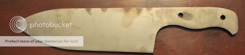

Whatever that means. Hi everyone, I'm new here. I've made 3 knives so far, all out of S35VN heat treated by Peter's. Two chef's and a small edc type. I've been struggling with how to finish them, and was hoping you guys could lend some tips so I could figure out what I'm doing wrong. I'm working right now on Chef 2.0, and I want it to look nice as it's a gift for my sister. She'll appreciate the imperfect look that I have on it now because it just screams hand made, but I'd like to see it a little more refined.
I'm not going for a real mirror here, but more of a very fine satin. Basically, I'd like to end above 600 grit, maybe at 1000. Here's what I've done:
After HT, finish off on a new 220 belt with light to medium pressure to get a uniform finish and smooth things out.
Move to hand wet sanding with a wood block, starting with 320, then 400, then 600, then I quit.
I use various techniques, heavy pressure and slow controlled movements, light pressure and rapid back and forth, and everything in between. I try a lot of water, I try it nearly dry. I change paper every 10 minutes or so, though at that fine a grit I can't really tell when it's used up till it's dry.
The problem is, I can't erase every scratch from the stage before. As it sits now it has some very subdued belt scratches with maybe a touch of 320 (I start the 320 the same direction as the belt), and a very few 400 scratches going across (handle to tip) that just will not come out no matter how much or how hard I do the 600. There's no point going beyond that I feel, because it'll just add more chaos.
My questions are:
How long does each grit generally take?
Soaking wet or almost dry?
Hard, soft, fast, or slow? ;)
Do any of these factors change as you go up in grits?

Hand-sanding high-alloy steels like S35VN after they're HT'ed is sheer madness. It can certainly be done, but it's going to take a lonnnng time. That quiet evil noise you hear in the background is the chrome and vanadium carbides laughing at you...
Since Peter's is doing your HT, you can confidently grind your blades to final dimension and bring them to whatever finish you want before sending them in. I've never had a stainless blade come back from Peter's warped or bent. After HT they just have a light layer of oxide coloring on them, and that sands off fairly easily.
All of my knives are hand finished and I can say this with certainty. The only way to know for sure that all of the previous grit scratches have been removed is to sand in an opposing direction to the previous grit. If you come off the belt at 320 with a vertical scratch pattern, you have to start hand sanding in an opposing direction to that vertical pattern to remove it. When you think you're there, thourougly inspect to ensure that you've removed all previous grit scratches before moving up in grit. It's really that simple. Other than that, my biggest tips would be proper lighting and good paper. I use Rhynowet Redline. Oh yea, often you may have to start out hand sanding at a much lower grit than you'd like. In other words if you come off the grinder at 320, you may have to start as low as 120 hand sanding. It really depends on how good you are at the grinder. I took some suggestions I received and also recently added a disc sander to my shop. The disc sander can help to "level" the surface out better after coming off the grinder to make the hand sanding go a little quicker and easier.

The first steps are the most important. If you really want a sweet finish, don't start hand-sanding at all until you're really happy with your grinds*, and don't even think about going to 400 until you have a very, very clean and even 220 grit finish. Once you get to a clean even 400-grit finish, subsequent steps go quicker and quicker. I'm convinced this approach actually saves time overall. :) The only other "answer is to just learn to embrace machine finishes, whether they're fine belts, Scotchbrite belts, tumbling/media blasting or whatever.
* I do just a few strokes lengthwise with 400 just to make any slight dips or divots stand out during the grinding process. That only takes a few seconds... if you have a wavy spot or a "dreaded 2-inch mark", it will jump right out at you.

Thank you all, great info!
I had watched that first Nick Wheeler video a while ago, and it spurred me to put a 400 grit finish on before HT. It was pretty easy, especially compared to what I'm trying to do now, and it came out looking great. It came back from Peter's with a frosty like coating, not a scratch in sight. I guess I shouldn't have taken it back to the belt after...
So next time I will put the finish on before hand. I have a one, maybe two knives left worth of this steel so I'll see how it goes. I'm going to leave this one where it is, because it is kind of a cool look. A mixture of polish and grind lines. Maybe I'm on to something here?
