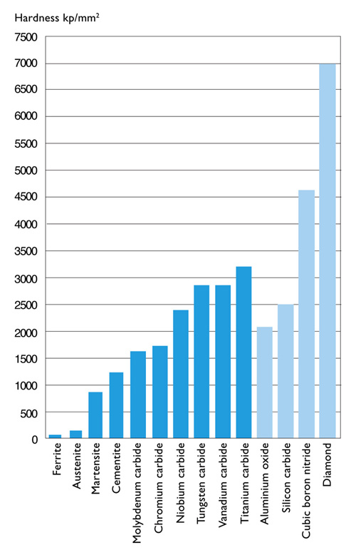

Hi all,
Recent discussions on the effectiveness of sharpening stones on high vanadium steels made me curious about the hardness and abrasion efficiency. I searched around the internet and found some numbers of common materials’ Knoop hardness as listed below. From this, it makes sense to me that one needs to use Diamond abrasives (or CBN) for steels containing a good mount of vanadium carbide (when polishing is desired). Also, for high hardness steels above 60 HRc, I would need at least an alumina ceramic stone, as tempered martensite is as hard as quartz, the main abrasive in natural stones.
As a disclaimer, I am no metallurgist. So, I would appreciate any inputs from metallurgist and sharpening specialists, as well as other sharpening enthusiasts, particularly whether this argument is reasonable and legit.
Miso
Material Hardness Table
Code:
Material                         Knoop        Comment
Glass                            530
Tempered martensite at HRc60     700          Value questionable
Quartz                           820          Silicone dioxide, Arkansas stone
Cementite                        1025         Iron carbide
Chromium oxide                  ~1200         Green compound (with alumina)
Zirconia                         1600         Zirconium dioxide
Zirconia toughened alumina       1700
Chromium carbide                 1735
Molybdenum carbide               1800
Tungsten carbide                 1880
Aluminum oxide                   2100         Alumina
Silicone carbide                 2480         Maybe harder due to hardness anisotropy
Vanadium carbide                 2660
Boron carbide                    2750
Cubic boron nitride              4500
Diamond                         >7000
(Vickers? hardness from Uddeholm)
Summary from the discussion below:
(1) Natural stones like Arkansas (quartz, silicate, or novaculite) may not be the first choice when sharpening high carbide volume steels.
(2) You can use any good ceramic stones (alumina and above) for a coarse finish above 10 micron or below #1,000 ANSI grit.
(3) You would need abrasives harder than carbides for finer finishes, if you want to save time and effort. For vanadium carbide steels, this would be cubic boron nitride or diamond. Alumina and silicon carbide can still work but not efficiently. This may also apply to strops.
(4) Alternatively, one can use diamond lapping films instead of stones for finer finishes.
Just a few comments regarding the chart. Untempered martensite is typically harder than tempered. Arkansas stones will work on 1095, though the carbides in 1095 are cementite, though only 2-5 percent by volume and quite small. Coarse stones can ignore harder carbide as long as the volume isn't too high and the carbides are significantly smaller that the stone grit. Problems arise when trying to polish with to soft an abrasive that is similar in size to the carbides or when the carbide volume is to high.
Thanks for the comment, me2. Can you elaborate on the hardness of tempered martensite vs untempered? I understand that tempering reduces the overall hardness of steel for better toughness. But I do not know how to translate this to the hardness of martensite itself. Some sources say that the reduction of overall hardness comes from the conversion of some of martensites to softer structures.
The numbers I listed above for martensites are from separate sources. I have not found any reliable sources describing the hardness of tempered and untempered martensites in a coherent context, and therefore am having hard time to understand this.
Miso
Ah yes I can see how that would be confusing. The hardness of untempered martensite depends primarily on the carbon content. Up to about 0.8% carbon, the hardness increases, after which it levels off and can even drop down due to retained austenite levels increasing. Tempered martensite can go up slightly, depending on the alloy in question and the overall carbon content and temperature involved. I get the point that hardened blades are similar in hardness to natural novaculite stones, or maybe harder. Also I'm only speaking of low alloy carbon steels. Lots of alloying makes it more complicated than it already is.
Using the first google search for hardness equivalent charts I found, and assuming an as quenched hardness of 68 (not too uncommon), that is equivalent to 920 Knoop hardness, just under cementite hardness, but harder than Novaculite (Arkansas stones). Novaculite being approx 64HRC (820 Knoop). Very interesting.

Thank you, guys, for the discussion. I know that the real-world sharpening is not this simple, but think that this can be a reference for beginners to choose their steels and sharpening stones.
I think the concrete analogy FortyTwoBlades gave is pretty intelligible.
When you grind this mixture of stones and cement with a soft file (but harder than cement), of which grit is bigger than or similar to the size of the stones, the presence of the stones may not matter to the result, in terms of morphology. When you try to refine the surface using a finer file (still softer than the stones), then the stones will appear as bumps and prevent the surface to be smooth. Of course, you can take time and spend a lot of replacement files to grind down the stones, but it won’t be efficient. Instead, you can use a file a lot harder than the stones and make the work more efficient.
(Note: The average size, size variation, and the total amount of stones in concrete would greatly affect the work and result, but this side is ignored here)
Alloys (steels) are like concrete in that they have hard non-iron carbides (stones) and softer iron-based structures (cement). One issue is that these carbides are much harder than natural stones and even many of ceramics. So if you want to grind them, you would want a sharpening stone (file) harder than them (or make a lot of and very consistent effort with a softer stone). Again, this won’t matter if all you need is a finish coarser than the size of carbides.
Summary:
(1) Natural stones like Arkansas (quartz or novaculite) may not be the first choice when sharpening current high hardness steels.
(2) You can use any good ceramic stones for a coarse finish above 10 micron or #1,000 ANSI grit.
(3) You would need abrasives harder than carbides for finer finishes, if you want to save time and effort. For vanadium carbide steels, this would be either cubic boron nitride or diamond.

some updates and some references
Hardness Conversion of Metals
http://www.tribology-abc.com/calculators/hardness.htm said:
1) Standard Hardness Conversion for metals acc. ASTM E 140 - 97, September 1999, Conversion for Non-Austenitic Steels, Table 1. The accuracy of the conversion depends on the accuracy of the provided data and the resulting curve-fits.

I agree in part with that bare strops remove weakened metal at the apex. But I think images ScienceofSharp provides show that they can also abrade metal to some extent. Also, I have read somewhere that linens and leathers do contain some hard minerals like silica. To be honest, I cannot find any reliable sources to back this up, though.
