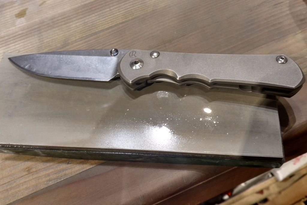

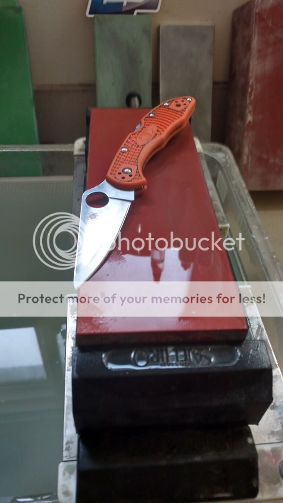

Wow. Thanks for the nice write up and images and for taking time to demonstrate this.
I hope you dont mind my asking a couple of questions.
The first one is whether you feel that the refinement you get with those alumina stones is similar to what you would get with diamond or CBN stones at the same grits, or alternatively whether carbides are really polished by the alumina ceramic stones (above 3,000).
The second is how much time you spent on each stone. I understand that polishing vanadium carbides with alumina is possible but may be very slow. If it can be done efficiently, then the hardness difference between them may not be as significant as I thought it is, or some alumina could actually be harder than vanadium carbide from certain angles to the crystal structures (or vice versa), due to potential hardness anisotropy bucketstove brought up.

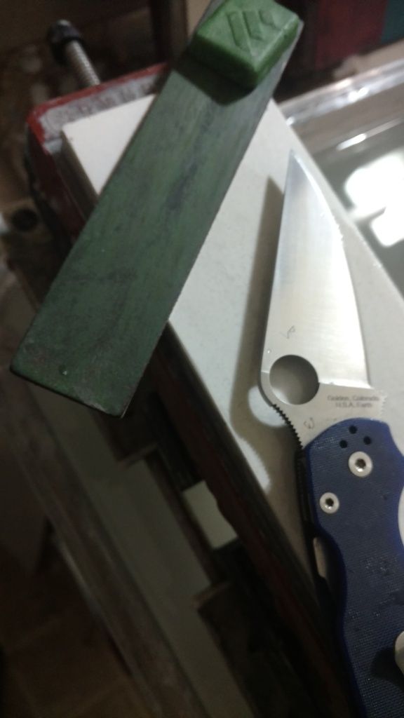

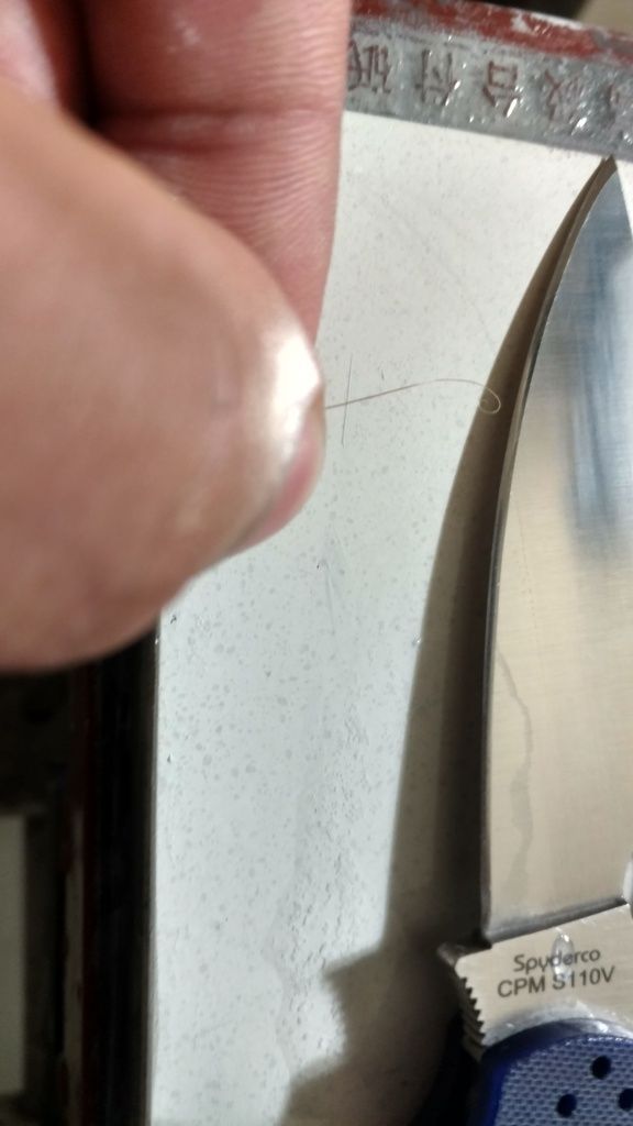

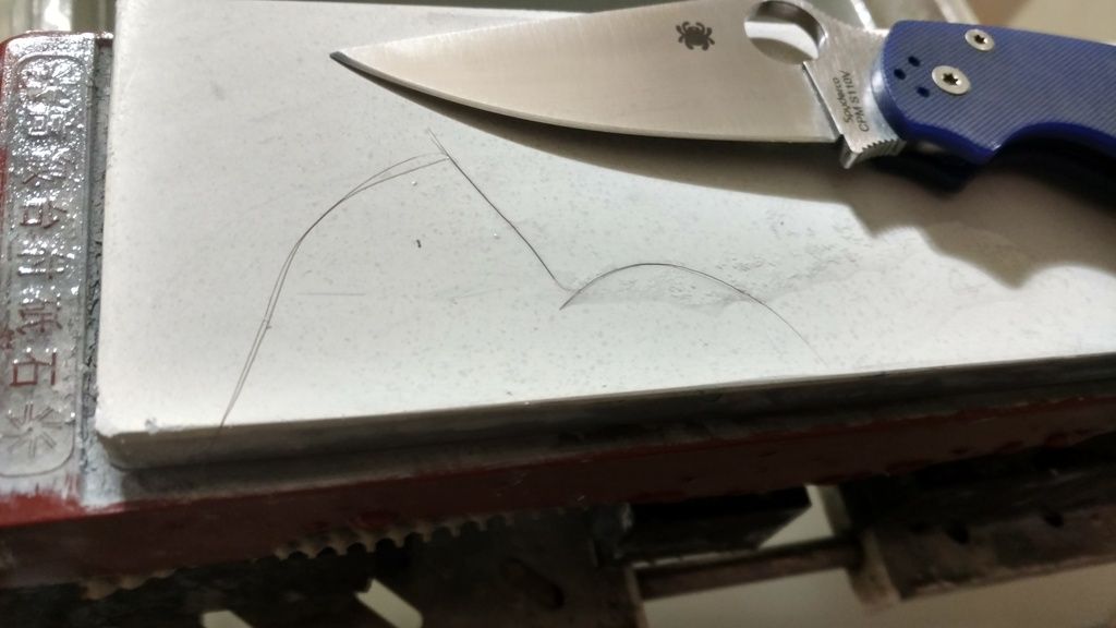

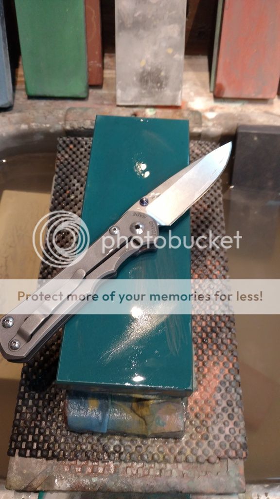

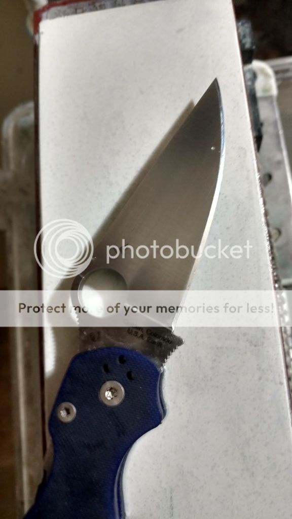

How do I feel about the edge? its sharp, I guess they can always be sharper though
Do I think I can make a better edge with the diamond? I feel it takes less focus and time maybe but tough to say without better controlled testing since I get all my data anecdotally.
Sometimes I feel like I get a crisper edge with the diamond, but sometimes I round the apex on the diamond and have to go back and fix it, is it crisper because of proper execution? or the higher finish the resin bond diamond leaves? I don't know, I've only been using these stones for 3 months now, need more time, also SEM pictures of edges would be sweet.
Do I think the softer alumina is polishing the carbide? I don't know, I know its making the edge shiny and it cuts better but I don't have enough physics, tribology and material science learning to fully answer that now, nor the imaging to show what is happening microscopically, so I can't answer that now and that's some thick reading and it takes a lot of reading and time to understand it enough to even follow what they are talking about as it relates to knife sharpening let alone explaining it in lay terms to others while still preserving the essence of what it means.
how much time did it take?
Not as long as you would think, Ill make a video when I get time, Maybe when my S110v edge dulls from use so I don't waste the expensive steel hahaha
Personally I like to just stick to steels with low or no vanadium carbides and suddenly I don't have to be fussy about what stones I use anymore.![]()
