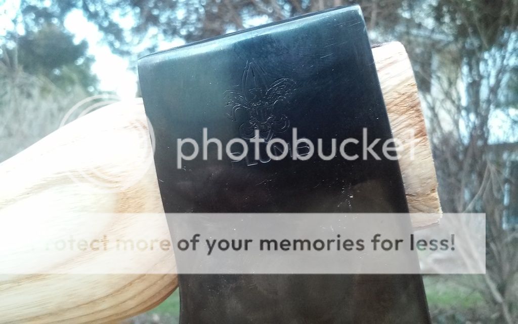

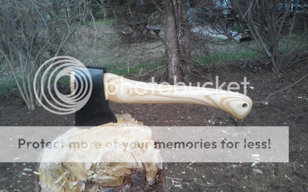

I saw a bunch on this thread but I didn't see any quite like this one. This is a Plumb boy scout hatchet I re-hafted. I put a mirror polish on it and gun blued it. Very time consuming but well worth it! Unfortunately, the (oxide?) coating wears off relatively easily and you can get some ugly scratches pretty quickly. Give it a try though, looks really cool. Buff, then blue.

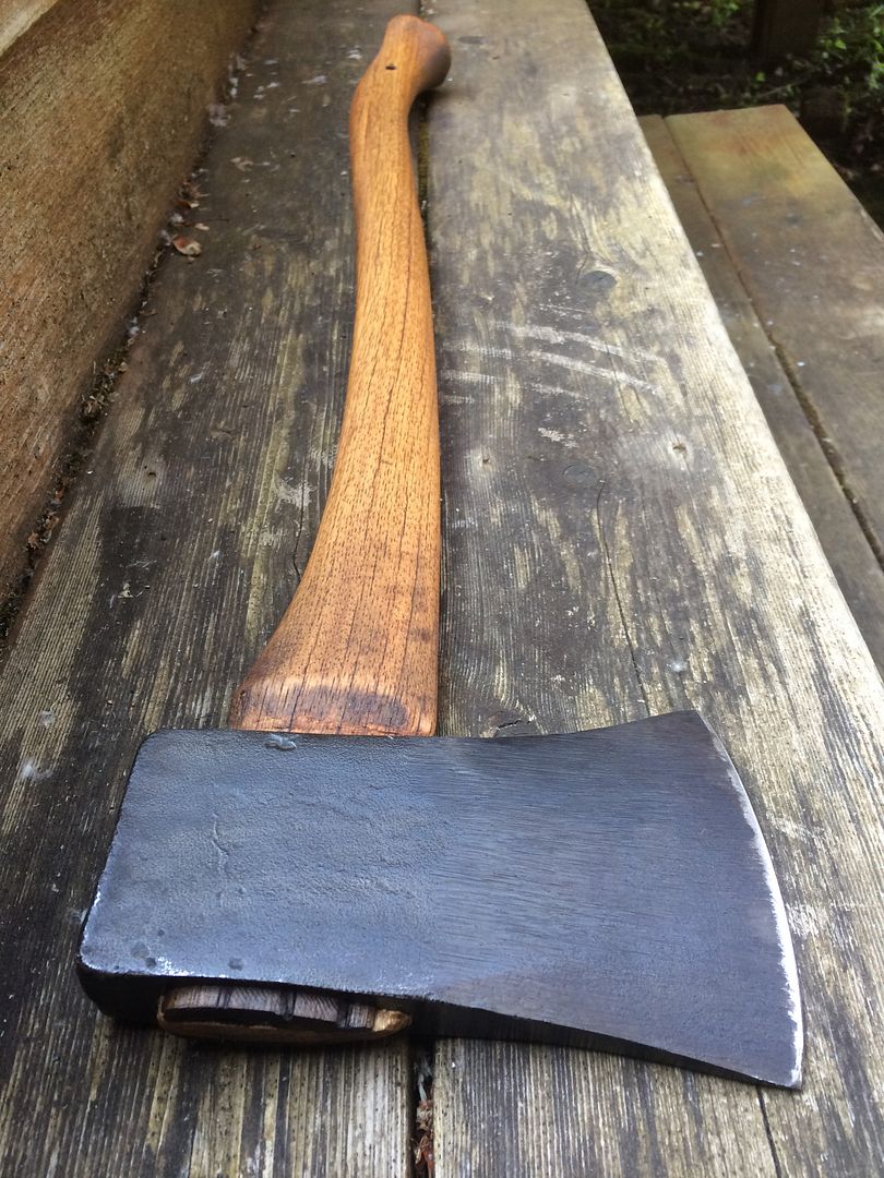

plumb_jersey_headtohead by city_ofthe_south, on Flickr
The Plumb on the right is obviously the blued head. The other one got an extra cleaning with vinegar. It had been painted and I think maybe laid on one side because one is more pitted than the other, and so it took a little more cleaning to get it nice which left it this gray color. It has streaks of wood and whatever else on it in the picture, but you get the idea.

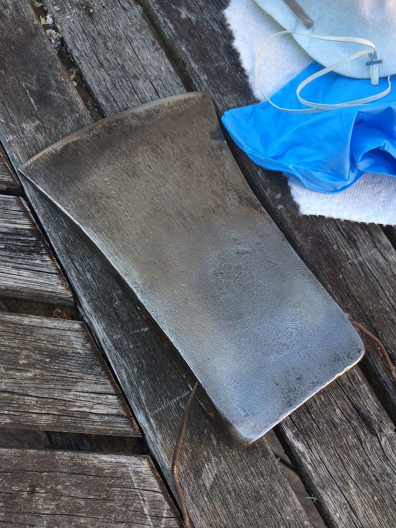

All I did to the Plumb was soak it in vinegar until it looked like the head on the left then degreased it and rubbed the cold blue on. The surface of the steel on the Plumb is still in good shape - some dings and dents, but not very much pitting.
I think that Plumb turned out great. Solid color.

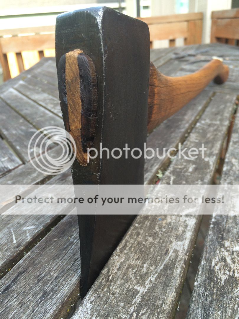

This is an unmarked boy's axe I rehung in the last couple of months. I gave it to a friend as a house warming gift.
