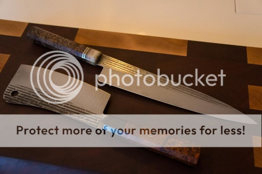

Look for old Ontario or Forgecraft knives on eBay, or decent old knives you can rehandle. Or you can buy new Old Hickory carbon steel chef knives very inexpensively, they are thin and sharp, exactly what you want in a kitchen knife. The only problem is they have stubby partial tangs so you will be restricted to making a wa style octagon handle.
Here are some examples:
An old Ontario carbon blade converted to wa handle:
A couple of converted Forgecrafts
Various other re-handled older knives:
