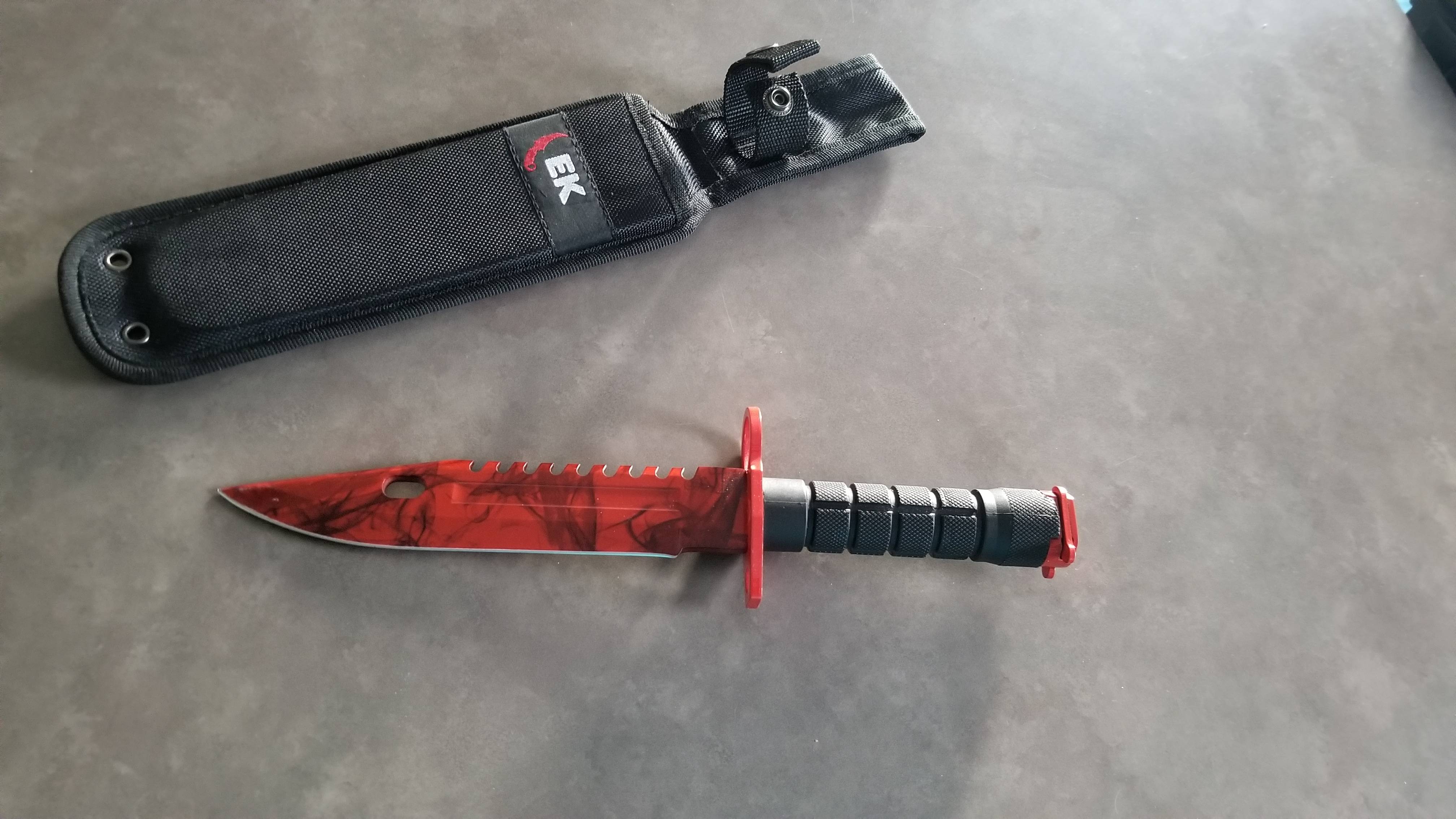

I ordered this replica knife of a video game and I thought I lost it but found it. I remember how dull it was. I want to use it as actual knife and make it really sharp.
Now sharpening knives... searching the subject seem to be so confusing man. So many stones, products and what not.
So I was wondering if anyone could help me out?

what steel is it?
How dull is it? Does it still cut through some cardboard?

Well I would not bother, this cheapo m9 bayonet style knife from csgo or whatever is a piece of crap and probably will not hold or take a very good edge.
My brother had an identical knife with a plain black blade that he bought at a flee market for 15$ and I could not get it very sharp for him at all. Usually when a cheap piece of crap Chinese knife doesn't come with much of an edge it's because it's made of butter knife steel.
If you do want to try and sharpen this though, for a knife like this you really only need a 2$ double sided sharpening stone from harbor freight.
You can even sometimes find dual sided sharpening stones at the dollar store.
BTW the stone you tried did you use water on it or use it dry ?

Yeah that knife is made from cheap steel that is hardened to a low level if at all you can put an edge on it but the edge will dull faster than you can sharpen it.
:) You'd be surprised.
The only way it could dull faster than you can sharpen it is if you're cutting rocks :) or you're taking more than 5 minutes to sharpen.
Elementalknives website says its "52" HRC, which is like basic machete hardness (50-55HRC)
I don't really buy or look at machetes but I know most cleavers are still at least 56 HRC which is a big difference from 52 HRC
