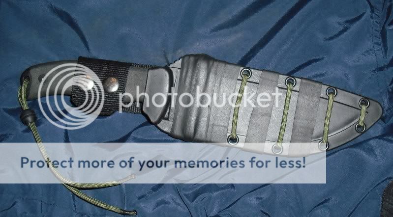

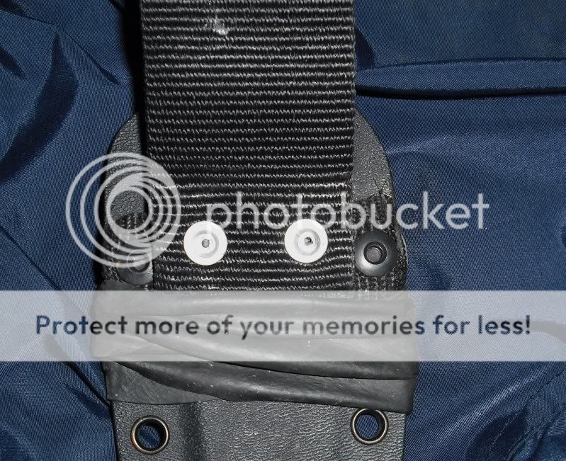

I made a belt loop out of some webbing & a couple of pop rivets & snaps:
This is how it's attached to an ESEE 3 sheath...same as on the 6:
The rivets only go through the webbing,not the sheath itself.
They ride lower & so far have been very secure.

what are those rubber.. bands? there for?
They can:
Keep the screws from backing out.
Hold some flat wrapped duct tape.
Hold a small fero rod.
Hold a TOPS foling saw.
Hold a small pry bar.
And probably lots of other stuff that nobody's ever thought of yet:)

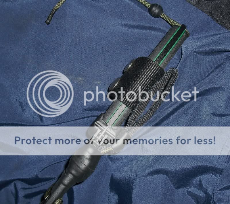

You just gave me an Idea. :D *starts looking for Mini Maglite sheath*

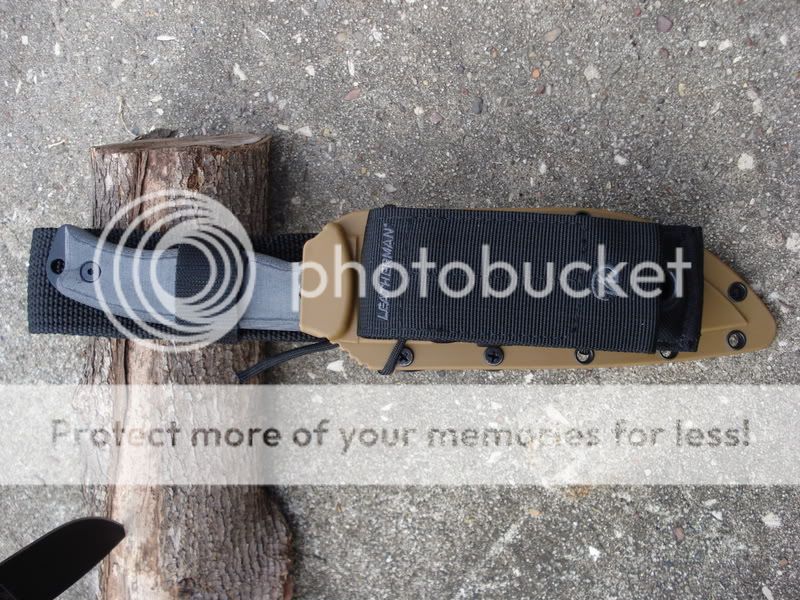

Do you make them for the lower ride option? I would love to set mine up like yours with my Leatherman mounted on.
i didnt care for the molle locks or paracord either so i carry mine on the esee molle back and with the pouch.
much more versatile and comfy with the molle back.

Cricket, would you mind posting a couple more pictures of that setup? I think I am going to go with that as I can carry more stuff with me. :D
When you go to draw the knife, does the whole setup lift up as well?

Cliff Nieporte , that's a really cool improvised system ; one I've had in my mind very recently , as I just got a RC6S. I'm using the paracord/cordlock thing , but want the whole system to ride lower , as the 6 in sheath is a little handle heavy compared to the 4/3. Pop rivets entered my mind also. Just have to score some webbing and do it. Great job !!
