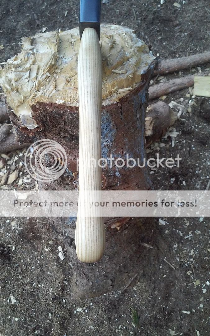

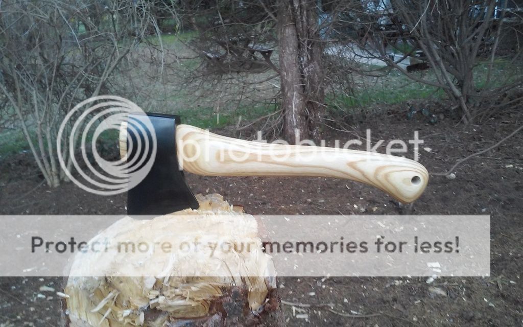

I go to my Local Exotic Wood supplier and purchase some 1 1/2" ash. Then i trace the pattern I came up with onto the board. I cut it to a rough shape with my jig saw and get the profile perfect with a rasp. I sand the very bottom of the handle with a belt sander to get a nice curve. I then begin to contour the handle with a spoke shave and a coarse rasp. I leave the part that fits into the eye of the head in a blocky shape so I can focus on that later. The overall shape and contours are up to you. Coke bottle shapes work great for hammers by the way ;) When shaping the eye, I stand the head up on the end grain where the wood will be and I trace the inside of the eye onto the wood carefully, using a pencil with thin lead. I make sure everything is centered and straight in the x and y axis and then use the spoke shave to take the to-be-eye down to the pencil line. I make that spot a bit smaller than the line and take the wood down bit by bit. I like to get it as far back as I can with the spoke shave and rasp. I then cut a ledge where I want to head sit and make sure it sits nice and tight there. once I have the head where I want it, I remove the ledge and blend the part that will fit in the eye with the rest of the handle. Before hanging the head, I sand it to 220 grit- a nice working finish- and make sure any burn marks from the belt sander are out (end grain on the butt end will burn easily). Once this is done, I seat that sucker on the handle HARD and pound a hard wood wedge and step wedge in with construction adhesive. Hasn't failed yet. I coat the haft in BLO but I'm sure there are other substances that work better-I just haven't experimented as much as I should :p
Dry wood is preferable and straight grain running from the front to the back is best. If you get it from the woods, i would dry it in case it warps, moves, shrinks, or checks after you hang it. Easier to just get some wood from a lumber store if you have one.
Here is what it will look like if you do it my way. i'm sure there are others :)
