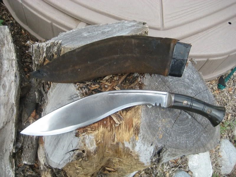

Moogoo, interesting concept. For wood, I haven't found the perfect solution. I've noticed Dhar seems to shrink horribly, while Neem stays perfect with no care. Satisaal is in the middle, but pretty good. But, I've had to shave steel on chiruwa handles, so your idea may be just the ticket. For regular horn maintenance, I'm sold on soaking horn in mineral oil. I acquired this beautiful WWII khukuri, but the handle looked horrible.
Before:
After soaking for at least 24 hours in mineral oil (plus a little steel wool on the metal). I filled a mayo jar with cheap Walgreen mineral oil and placed the khuk handle down.
That's not lighting. The 60+ year old horn looks brand new! I can also keep using the same oil over and over.
