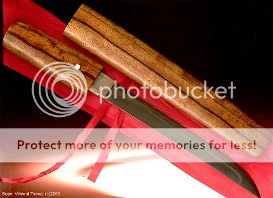

By using a simple flatbed scanner - please take a look at this post:
some general flatbed Scanners advice
sample of a scanned knife -

When I use a scanner I like to lay a folded blanket or towel over the item that I am scanning instead of a lid. It provides an interesting textured and colored background as well as controlling light leakage and reflection.
