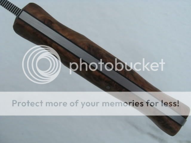

The handle/tang: The handle is sculpted front to back for a comfortable and secure grip. Very much like a palm-swell profile, the handle naturally locks your hand into position. The extended tang was designed to allow you to hammer or strike a steel with the sharp edge, yet not stick out like other ones and get hung up. Also, the shape of the handle creates an effective rear guard to keep your hand in place while hammering with a reverse grip. The handle material on this knife is stabilized redwood burl with stainless pins, but Nick does offer micarta and stainless pins as a less expensive option (the OD green micarta would look wicked!)
