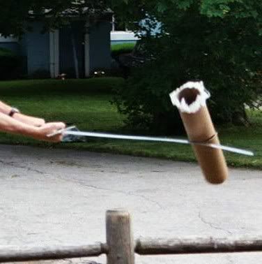

here are a couple of pics I pulled from SFI awhile back that clearly show the affects of harmonics and why it’s important to dampen them.
I think those pictures do a better job of illustrating that the sword will flex at wherever the impact occurs. Do you really think the sword in that first picture would flex into exactly that same shape if he struck the tatami with the tip of the blade, or behind the COM?
Harmonics can be managed through engineering however, fulcrum forces cannot. Fulcrum forces are the result of impact point, motion, kinetic energy and mass distribution.
The flexing you see are harmonics, the result of an off edge axis impact (or the target moving during impact) creating lateral forces on the blade. So if the tip impacted with an off angular impact I would expect to see some wave form in the blade as well. The frequency and amplitude would depend on impact force. Thin long blades would be more prone to this excitement however, how forgiving the sword is depends on how well it’s made.
Off edge axis impacts while cutting hard targets can snap blades because the lateral forces are concentrated at a small point. Think of when you drive the point of a knife into a piece of wood then apply lateral pressure on the blade, the result is usually a broken tip.
